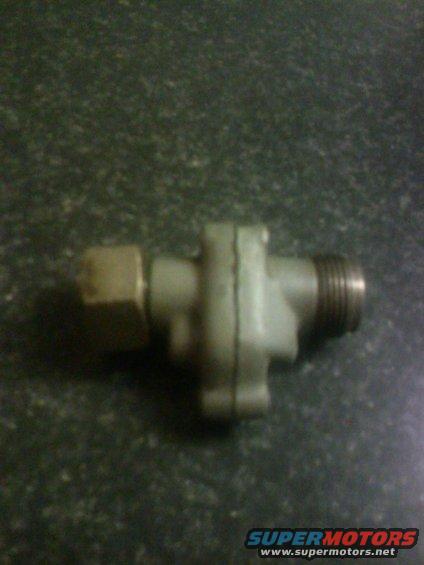

    wow I need to call them.. didnt think I could correct mine....
    I have the ratio adapter on my truck now..
    I have a smc465 matted to a np205. I have the ratio adapter that screws onto the xfer case.... then my cable to it (cable went bad so need a new one)
    didnt know I could change out the drive gear in a np205.... anyone do this?
    I will call them to see....
    pic sucks as it is my camera phone.... but i do have the ratio adapter.... just may need a different one...
    [​IMG]
    this adapter is stock and was to assist in fixing the speedo.. it has written on it
    SW in big print
    W9 on one side
    777F .9743D on the other side....
