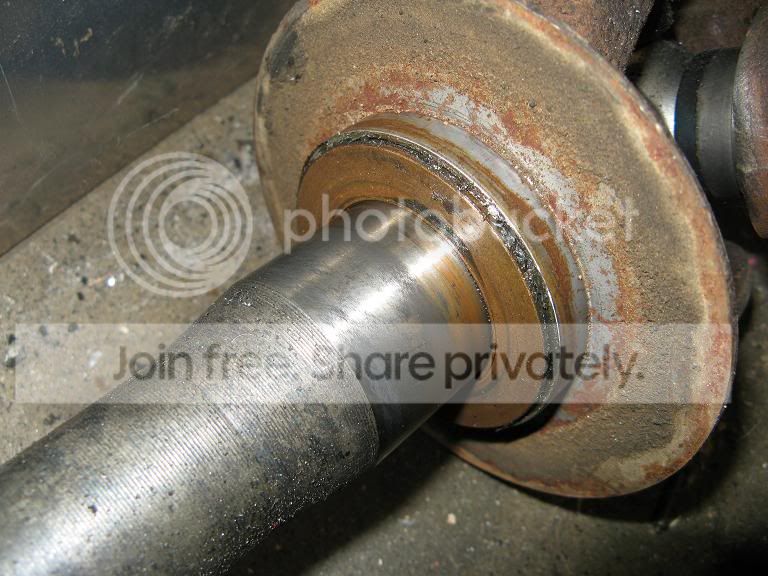

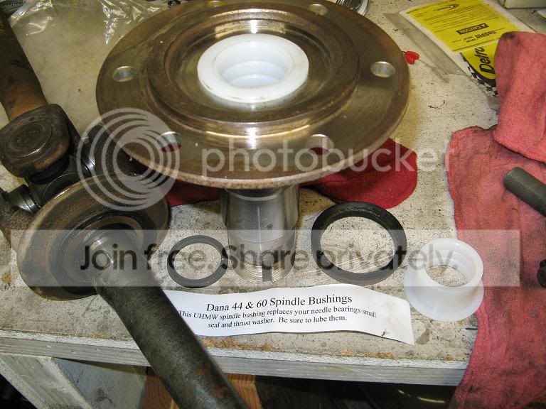

Not sure what to call it but I've replaced my axle shaft bearings with bushings. Just curious, which factory parts do I leave out? The small seal and the copper crush washer on the stub shaft?

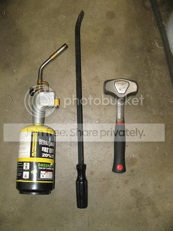

Just to show others what I used for the task. I heated the holy piss out of the bearing. Took my 3lb sledge and whacked away at my Harbor Freight pry bar. Worked like a charm. The pry bar has a really good angle on the end. Says Central Forged on the shaft, I recommend it, if not for this project, at the very least set it next to your driver's seat :D
