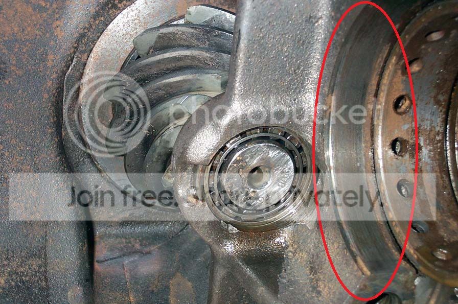

This isn't my 14 bolt, but here's the problem area....

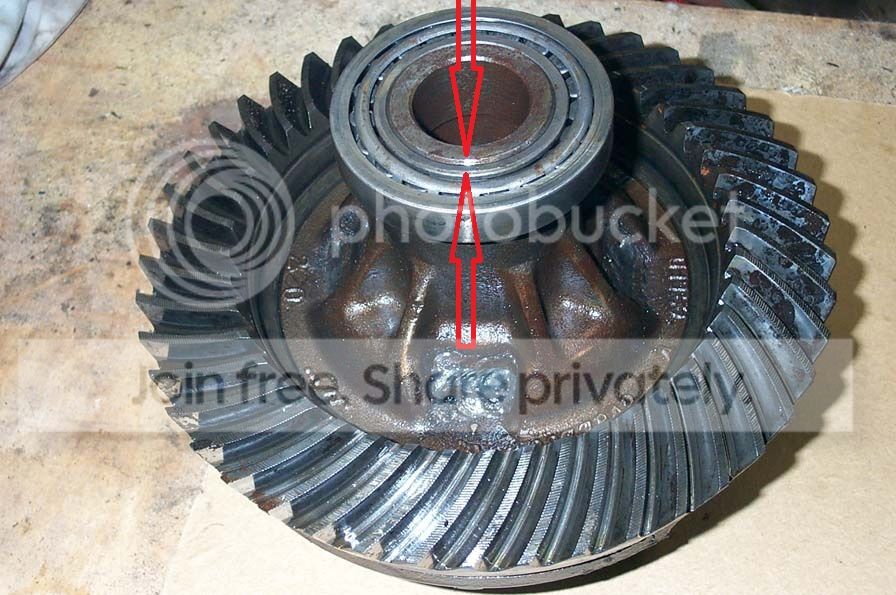

What I'm wondering is what would be the possibility that these two surfaces could be damaged/ out of spec?

Carrier is probably fine. Bearing is pressed onto carrier, but just clamped into housing. Usually don't have a bearing spin on the carrier unless the bearing seizes or the machine tolerances were incorrect.
