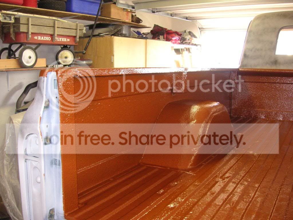

I've got the Al's liner on the inside of mine and it's fairly tough and is a decent sound deadener as well. I'm not sure about the heat resistance, but urethane (Al's) is usually not bad for that. I wouldn't use it next to a header or anything though. I did weld a body panel a few inches away from it and it held up. It did start to turn black at the edge, but hasn't peeled or lifted.

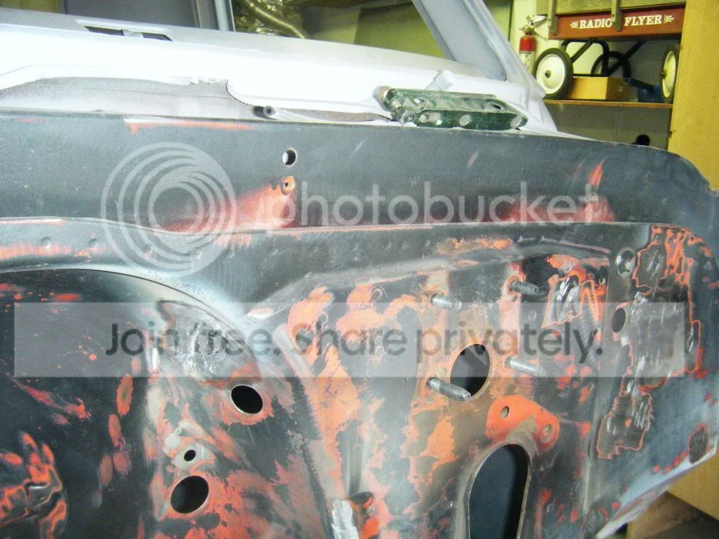

This question is for those that have used al's liner. I need to know if it will cover this and still look uniform after sprayed, or if I need to throw some filler in there to get things up to par. I filled in all the holes on the firewall I will not be using. I want all the spot welds covered too. You think this will look right?
I did mine when I went through my dually. It looks great when it's new but collects dirt, grease, and grime link e a mofo. I am going to have it sand blasted if I ever dig into it again and paint it gloss, either black or body color. Just my experiences. It is very forgiving and hides a LOT.
I might try and pop up those dents in the fender, but the liner should cover most everything you show.
Mine does collect dirt in the crevices of the texture. I might try and coat it with some armour-all or something after it's dry if you care about that.
Make sure you primer it well before spraying it too.
Yep, you can use any vinyl cleaner and it will clean it right up.
I had Al's in the bed of my truck (before the Line-X that was under it peeled up and took the Al's with it :mad:) and I'd haul dirt and rocky for some work I was doing in the yard. I just washed it like I did the rest of the truck and wiped it down with some vinyl cleaner and it shined right up.

Got it sprayed today, really happy with how it turned out. I got one spot on the drivers side floor where I went to go under the dash and some spilled out the top of the hopper. Other than that it was really easy.
