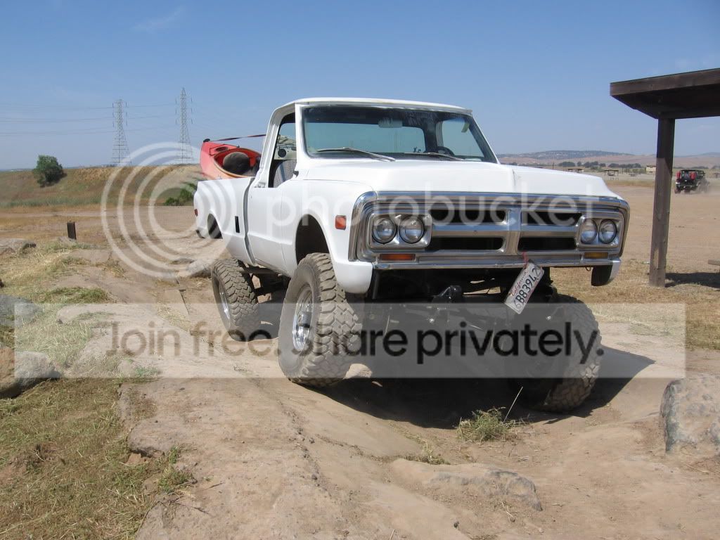

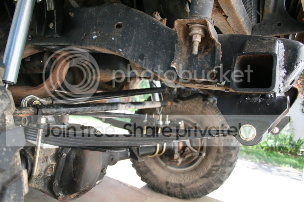

Here is mine. Keep in mind that the crossmenber in the front were only temporary.

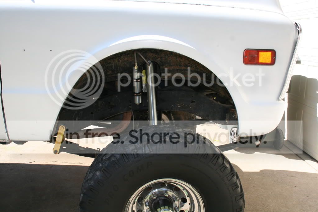

In that last picture, is your wheel turned, or does it sit forward in the wheelwell opening? If so, how much?
You should plan on moving the axle forward or your tires will smash your fenders.
These hangers are sweet if you plan on doing the standard 52" front spring swap. The extra holes will come in handy for adjusting shackle angle and you can knock out the old rivets in the body mount bracket. http://diy4x.com/cart/index.php?route=product/product&path=24&product_id=122

The wheel is turned a bit, but it does sit further forward. The wheel traveled so far up and back that I didn't want it to hit the back of the fender.
