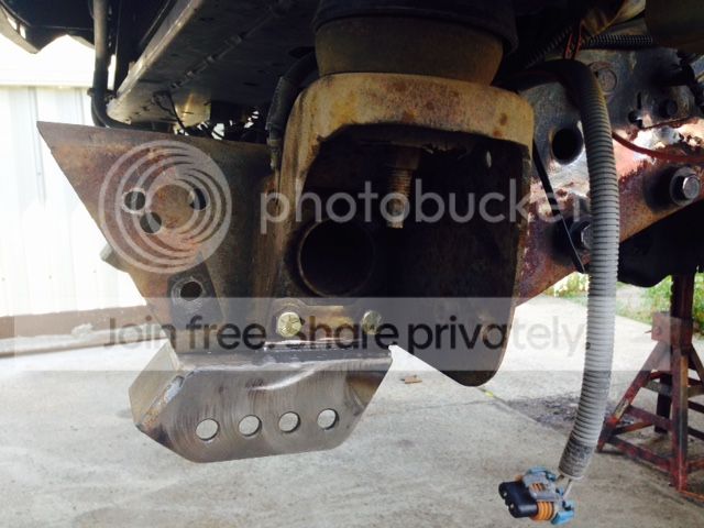

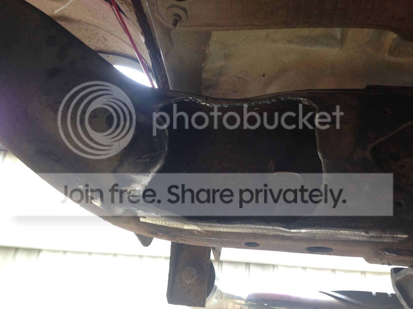

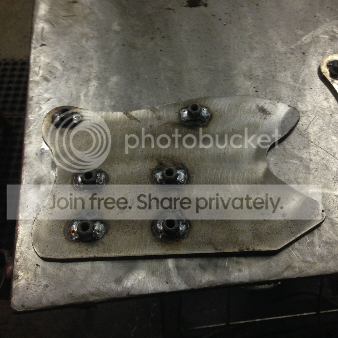

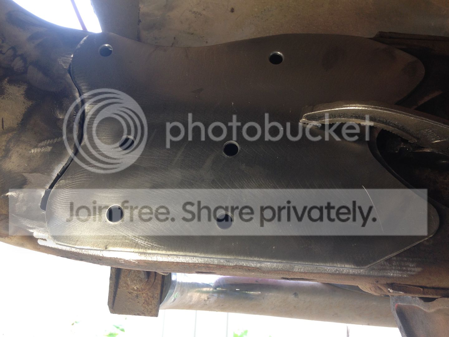

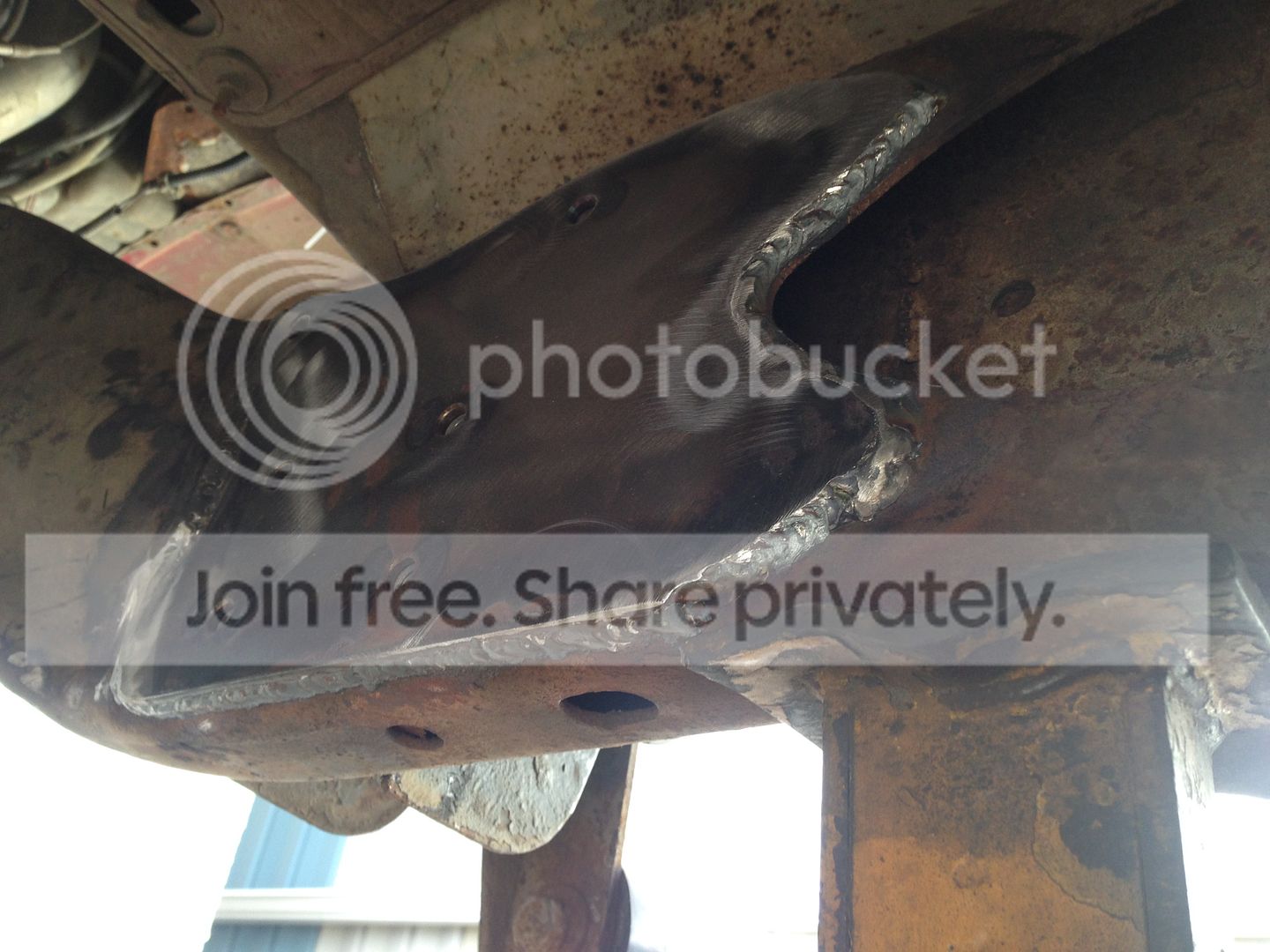

Couple shots of the front hanger. After these were taken, we added another tab to the inside of the frame rail. Pics of that to come yet. "shortly."
So then we come to the rear hangers for the kit and a decision has to be made.
This frame rail has a large bulge on it that will prevent any kind of good surface mounting for any bracket set. You got two options, trying to massage the frame rail flat.... Probably suck to do, or you can cut out the frame rail and put in a flat piece. Sort of like boxing a frame rail that was already boxed.

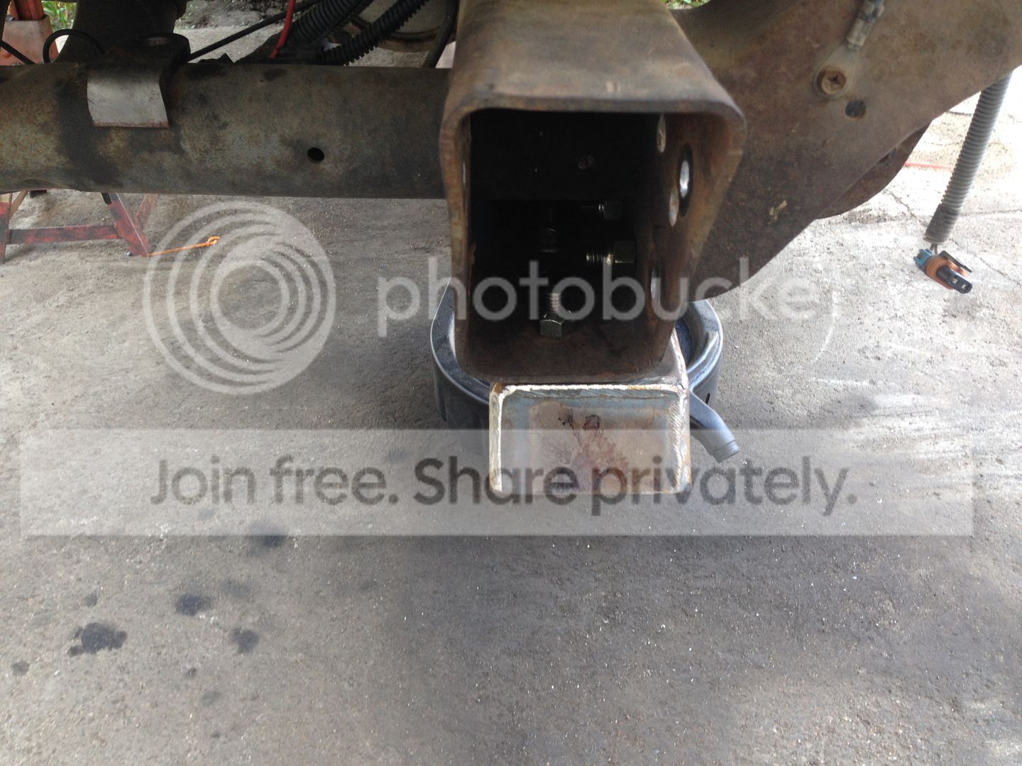

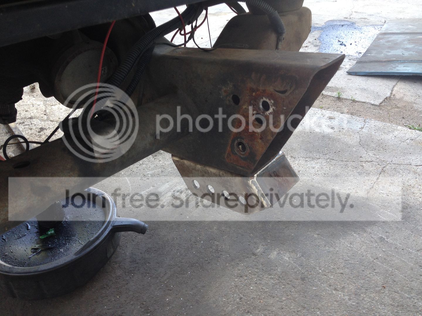

These are the rear hangers for the front springs. Much like our other SAS kit.
One of the guys had already hosed these with some paint.

We ended up having to add a cross member to the truck at the rear spring hanger location. Not sure how we'd handle this in the kit at this point.
