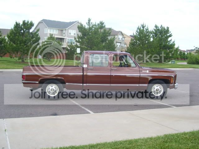

There any build threads showing what it takes to put a square body on a 88+ frame? Obviously all the body mounts are wrong, but i just wonder how wrong. Trying to see if an idea i have is worth continuing thinking about. Thanks!
Side note, i found this while googling! :eek1:
attachment.php
Cant find any more pics right now but this was the truck that gave me the idea many years ago.
attachment.php

Also, those two pictures of the 60-72 trucks is dead f***ing sexy if I do say so. OMG I need some time alone.
