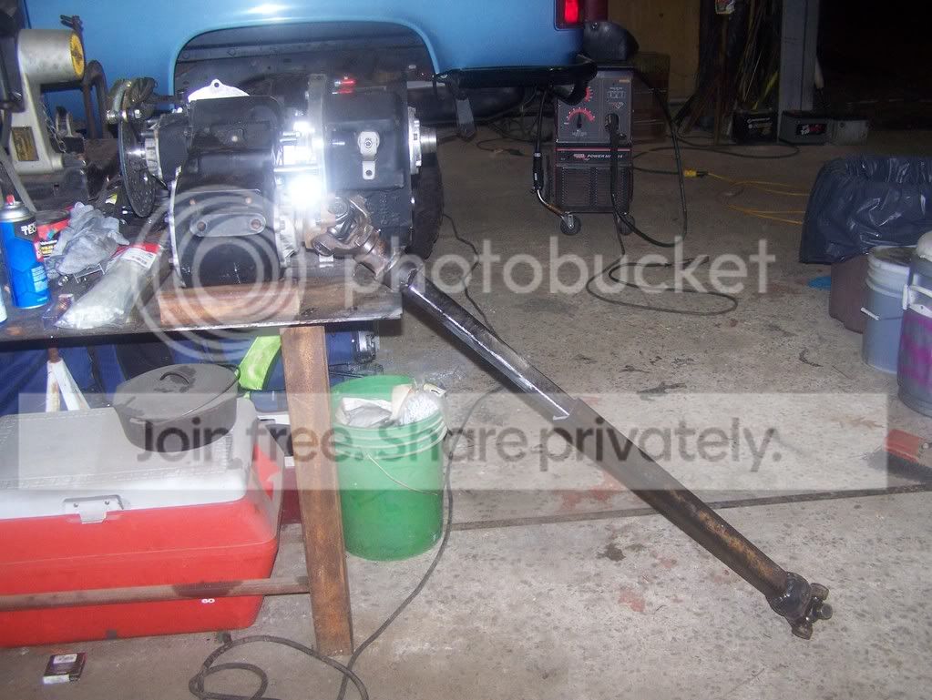

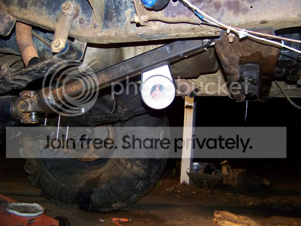

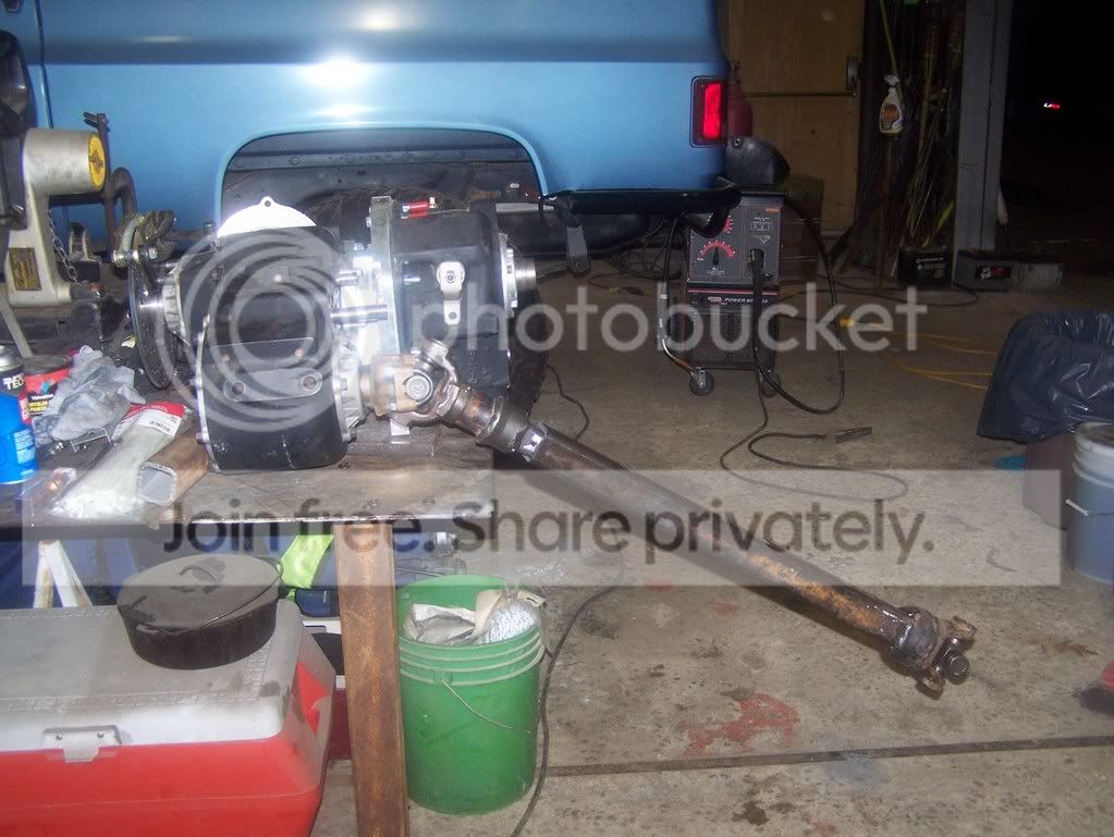

Here is mine. Works awsome with no noise.
I did a little grinding and changed the front joint to a Tom Woods offset super joint and it will drop far and give tons of angle.
