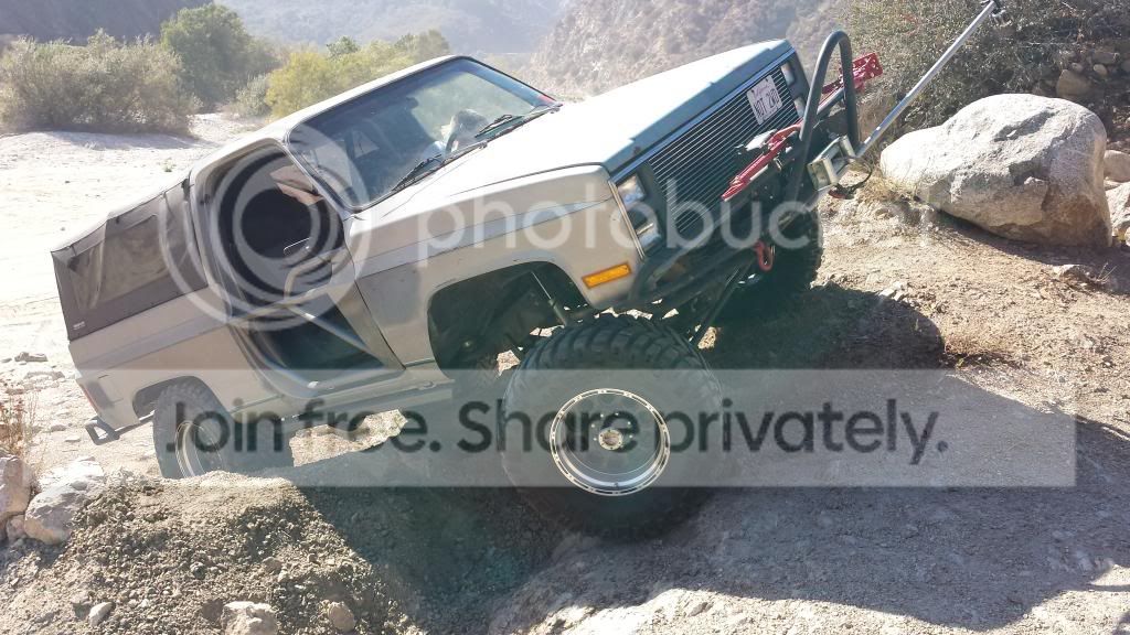

There are some pics in my build thread prolly around halfway through. Pretty similar to pumkins, but with steps cut into them and a little more rounded on the step bars. Mine are 3x2 main slider with 2x2 steps.

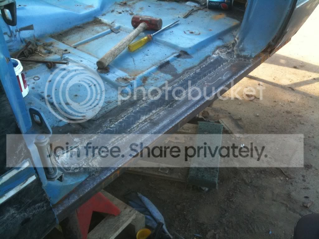

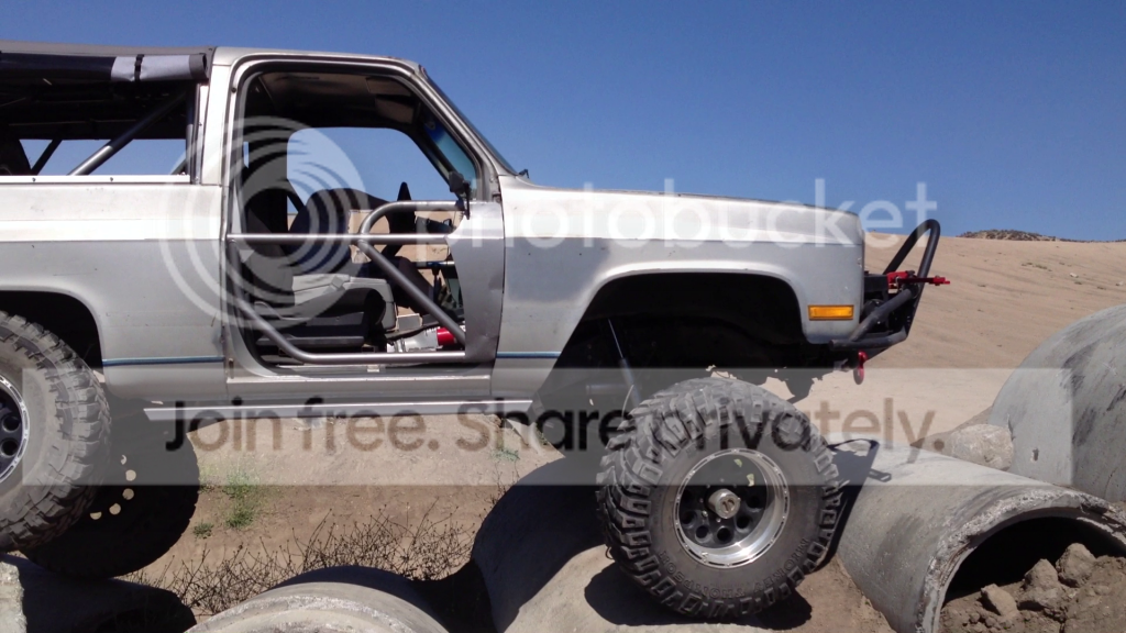

Here are mine. they are bolted to the bodymounts and to the frame with poly bushings. I cut the pinch welds to get the sliders up against the body. I never liked the look of the sliders below the pinch welds

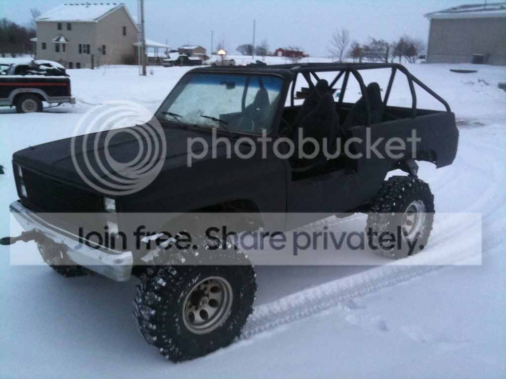

Also, here is a poser pic i did shortly after buying the truck from my pops. I really need to get rid of those girl steps! But the boss needs them to get into and out of the truck, so i may incorporate a removable step into my sliders.

Brian those look really nice!
Taking the time to put the little tread plate set-in step gives those tubes definite fabrication bonus points! :bow:

Thanks man! Actually functional too!
