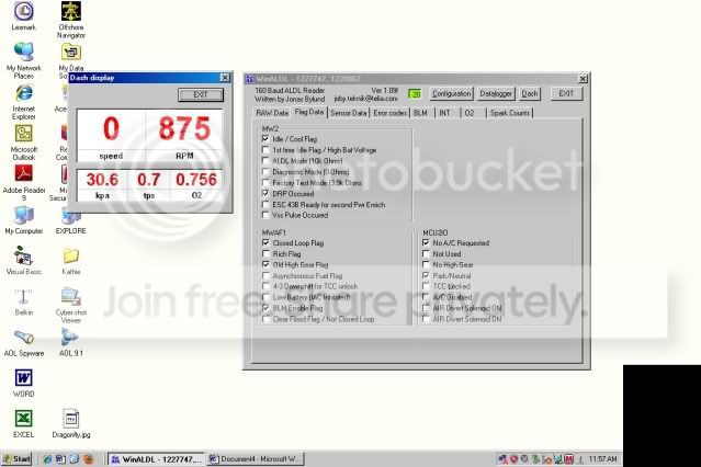

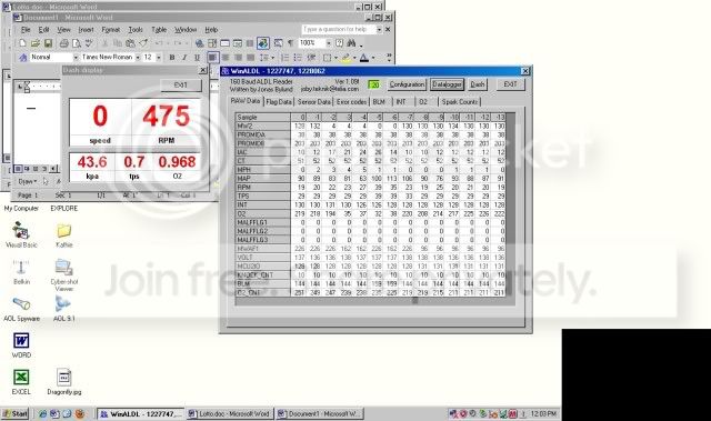

Spent last night trying to decide on the ALDL cable and Winaldl, or the AutoXray 7000 scanner.
I think that it is going to be most helpful to have more information. There are too many unknowns at this point. I need some data to help me diagnose this.
Thanks,
Here are a couple of WinADLD screen shot from my Jimmy.
