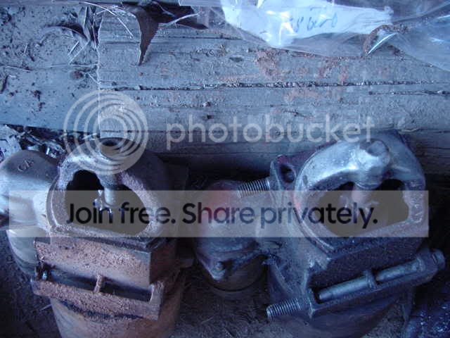

    The starter on the left came out of my burb, which is mated with a th400.
    The one on the left would grind and slip loose from the flexplate sometimes, and may have slightly boogered teeth.
    So I was hoping to use the starter on the right, which came from the motor I just swapped in. This was mated to a manual tranny (don't worry, I have the correct flexplate installed on this motor now). But the cone design looks different, and it seemed like it wanted to butt up against the tranny, when I tried to bolt it up a few minutes ago. Perhaps I was just holding it at a bad angle, as its kinda awkward to do.
    SO: Will these starters interchange?
    thanks,
    James

    Yes the nose coses on the starters are interchangable

    some really old ones from the 60's (yeh I worked on those alot, as those were my first cars) had a staggered bolt pattern, instead of the parallel pattern, that late models have.

    The difference is 153 and 168 tooth flywheels. Staggered for one, parallel for the other.
    IMO the nose cone should be kept when swapping starters...it's what sets the flywheel to bendix engagement. When starters grind, that's typically the reason. If the nose cone is kept the same, the relationship stays the same. I know they've got a bushing in the nose, and if bad, it should be replaced or swapped, but if it's good, I see no reason not to keep the nose cone.

    well, I took off the starter on the left, and I DID end up sucessfully bolting up the starter on the left to the new motor. The flexplates are both 168 tooth. my old starter did grind, and I'm not sure why (I think the old flexplate had some worn teeth) I'm really hoping the new setup doesn't grind.
    When I bolted up my torque coverter to the flexplate, it was kinda odd, because two of the bolt holes seemed like they were seated right against the flexplate, but one of the bolt holes had the flexplate and TC sitting about 1/2 inch apart... I hope this doesn't mean that my flexplate or torque converter is warped...
    whatever be the case, I guess I'll just get her put back together, cross my fingers, turn the key, and pray not to hear that nerve shattering metalic squeal.. :doah:

    You may have to shim the starter away from the flywheel if its grinding, indicating not enough clearance between the teeth of the starter and flywheel.

    I tried to put an automatic starter in my manual one time and the bolts lined up but the starter didn't engage the flywheel enough and the teeth just ground. I would not do this as new starters are a lot cheaper than flexplates and trannys. You could pick on up for $30 at Auto zone. That is better than crossing your fingers.
