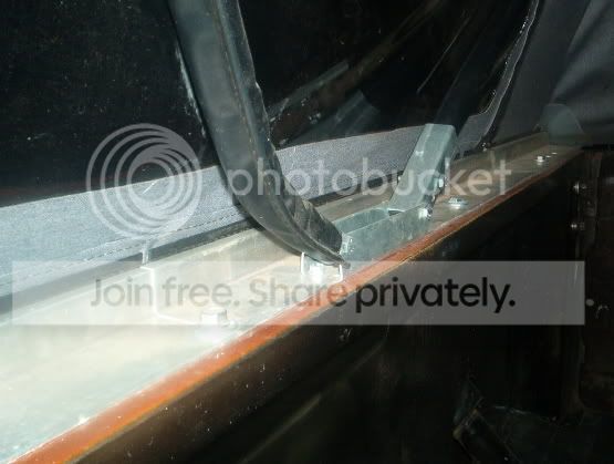

here's some pics of the fast trac....

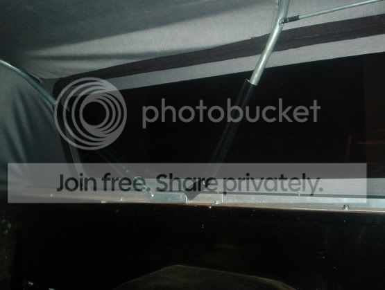

ya have to drill this hole iirc..

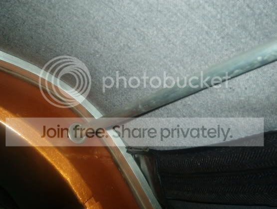

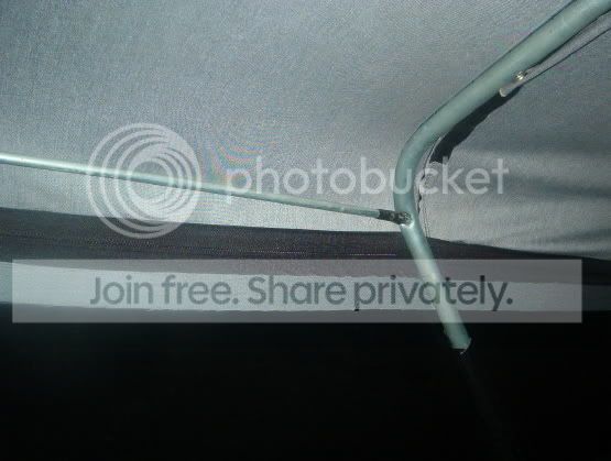

heres the bow pivots

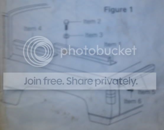

and a really crappy scan of the directions.. it's pretty easy to figure out.. it clips into the rails mounted to the bedsides..
