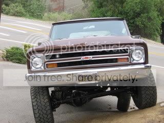

ok i searched and all i keep seeing was 37 inch tires for sale and stuff like that. i have a 1967k20 with: rebuilt ps box bought from ebay (private party:( ), stock ps pump not for hyrdoboost:( , beefed up frame for power steering(didnt have it originally):D , ord crossover:D , dana 60:D , a hydroboost with custom made lines (Russel) and 33" tires.
my question is: will i be able to turn my new 37" tires with this? how much harder will it be on steering parts like rod ends, ps box, knuckles etc. would i need a hydro assist? i never really thought about steering issues i might have until now...thanks
I can turn my 37/12.50s lock to lock easily without moving, I have an 84 CUCV with hydroboost, however when I get 42s I will add assist. You will be fine with just hydroboost.
