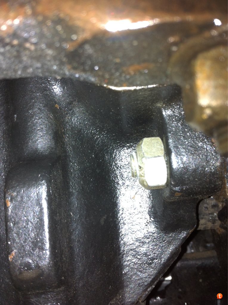

What length is best to accept the locking nut? Also will that same length work with ORD bolt on brace or longer is needed in the situation?
I do not remember how much longer I bought (I do have both the weld on and bolt on brackets). When are you putting yours together? I bought a reman steering box to put on mine (leaking bad) so I'll have it apart to measure but it'll be a week or 2 as I'm headed out of town this weekend.
3 1/2 work.. this is with the weld on and Bolt on ORD braces
