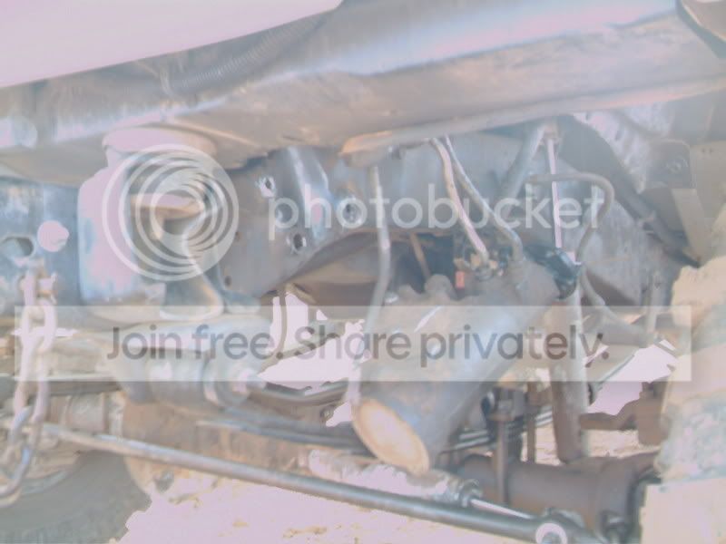

Not a great pic but this is with the steering box brace. The brace did do its job, it was so strong in fact that it pulled the threads through the steering box:eek1: . I now have both the brace and weld in frame piece, with longer studs, and threadlocked nuts on the other side. Never can be too strong.
