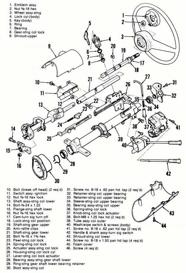

Do you think you still have all the pieces? If so we could maybe help guide you getting it back together

I found this its part of 3 pages with specifics. I know there are many that will work but hard to sift through when purchasing .

I do not think that speedway column will be correct. would bolt in, start, steer, and signal probably. You'd need to figure out high beam switch, and wiper switch. I do not think they can switched over unless the column was made to do so.
What is the info from in post #12 ?
