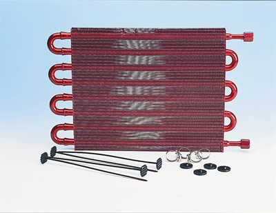

Like this one?
OK...that's what I was planning on using. I think it'd be fairly easy to purge either way...and the single aluminum tube coolers are two to three times the cost. :doah:
