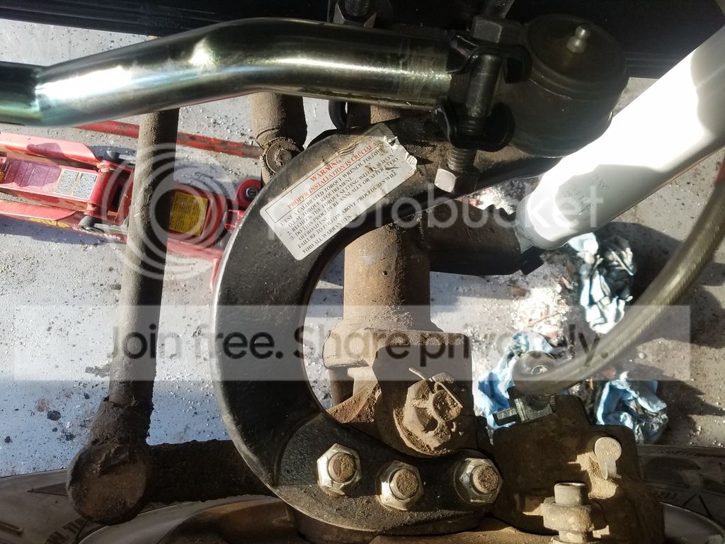

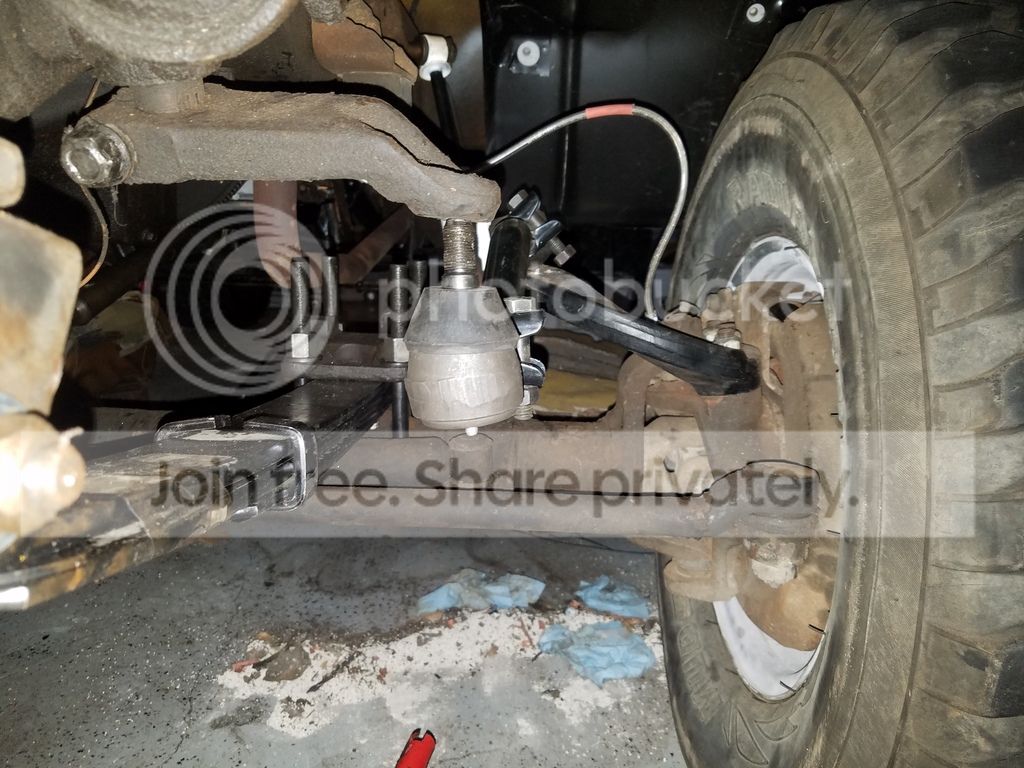

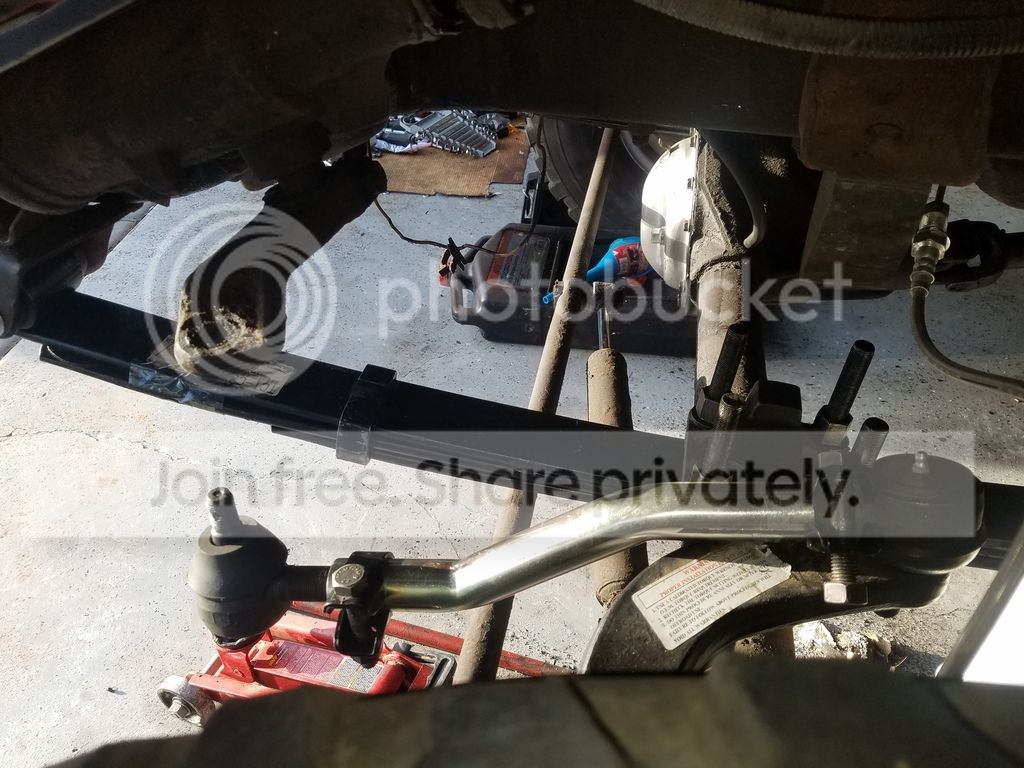

Pictures of current and before scenario?
Forgot to mention that these are all current condition. I unhooked the adjustable drag link from the pittman arm when I swapped out springs and shocks. Didn't want the weight of the truck on the steering. As you can see, adjustable drag link is still attached to the raised steering arm.
you might get away with just the stock drag link . but i think you will need to swap to a shorter raised arm or stock arm .
that combo now looks super close to being past the safe points like stephen said in the link i posted .
