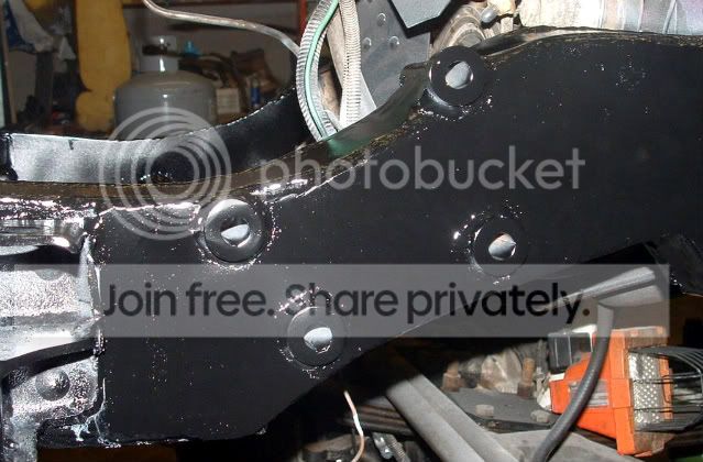

I moved the steering box forward on my old blazer.
Its not simple. Forward about 1" and up about 2" if I remember.
It was literally such a pain in the but to do I could cut the frame off in front of the motor mounts and rebuild the whole front end to do it.
It would work better though if you used a smaller radiator
How I did it
