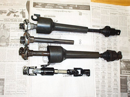

The other day, XXXXXX and I were looking in a local junkyard for a shaft
for his '70 Monte Carlo. We walked by an Astro van with the front mostly
removed off of it. Those vehicles use a shaft with two U-joints (one with a
damper built in). I grabbed the shaft for $25 (too much!). I didn't realize
at the time, but I already had a picture of the shaft (from a van) that XXXXXX sent to me. Look here, it is the bottom shaft in the pic:
www.dorianyeager.com/index2.html
