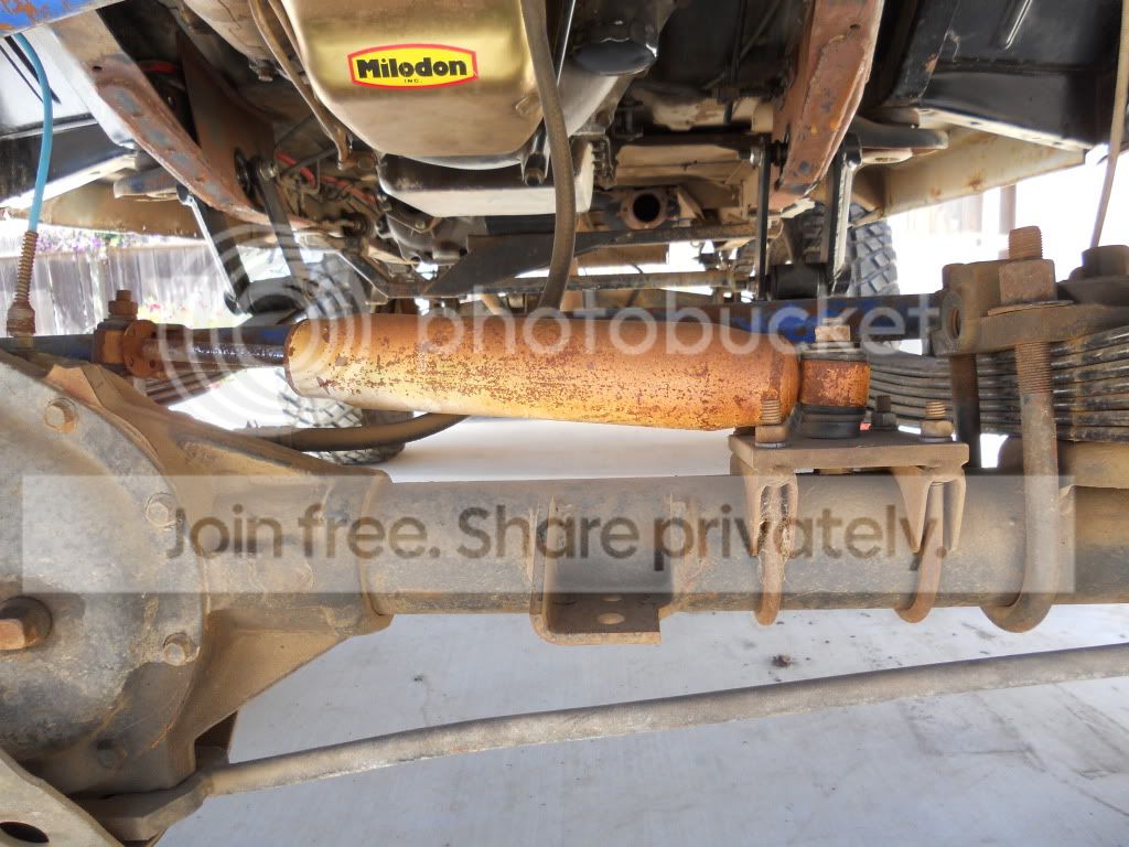

I just rigged up a stabilizer mount out of a pair of 3" muffler clamps with a piece of 1/4" plate over the top and then I bolted the stabilizer stud vertically through the plate. The stabilizer is now directly on top of the axle. The tierod just has 2 tabs welded to it. I honestly couldn't tell a difference with or without it on there, but I already had it so I figured it was worth a try. I'll try to get a pic later today if you want.

here's the pic:
did I mention that it's been collecting dust/rust for a few years?:whistle:
