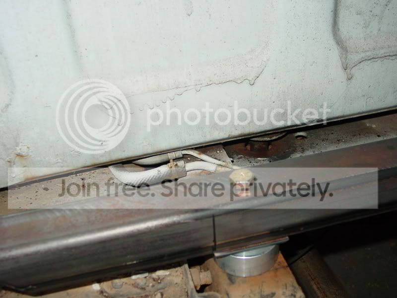

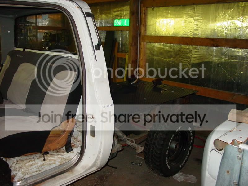

    I thought I had some other pics, but I guess not. Here's the two I have. In the first one, you can see the 2x2 tubing on top of the body mount. I welded a 1/8" plate to it to get the proper height. This put the top of the tube exactly 1" above the hump in the frame rails, so I welded in some 1x2" box tubing to sit on top of the hump to give more support. The interior parts of the frame were 1.5"x1.5" to save weight. The second pic shows the diamond tread sitting on top of the frame that you can't see.
    Probably not a whole lot of help, but feel free to ask any questions.
