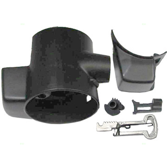

Well, here is the best pic I can find of the part that you need. This is from an article on how to repair the all too common loose tilt mechanism.
http://www.chevyasylum.com/column/tiltcol.html
Compare your cover to the picture above. You will see your missing part there. The cover aligns and locates this part so that your dimmer switch can actuate properly. Hope that helps. I will look some more and see if I can find a better pic on the interwebs.

ok, here is a better pic
Black part in middle on right side.
This is from evilbay auction:
Clicky
I would be willing to bet you can find it at your local GM dealer.

Ok, with the last picture that was posted i circled the piece that you need along with the cover.
My Cover......
Ok, here is my cover. looks like I am definitely missing that piece. Chances are this cannot be purchased at parts store, perhaps I can get this from GM. Also, does this just clip in the top of the cover? Thanks
Yep! Missing.
I would just go to the dealer. Should not be that expensive as it was used in a TON of columns from trucks to cars. My guess is they will have it in stock.
The part does not clip in, it just sits on the cover and then the cover holds it in position next to the column. The part can then slide freely back and forth to actuate the dimmer switch. Once you actually lay your hand on the part it will make sense.

That kit picture that rufus posted is the same kit that is available at Autozone. It is about $66 for it though. I would bet GM has just the piece you need for less than that.
