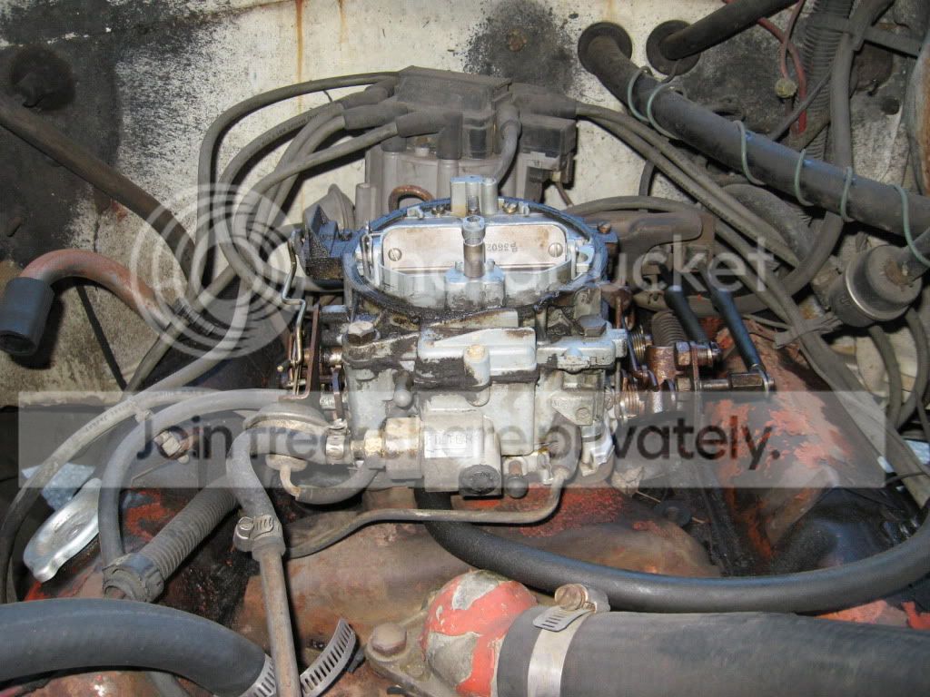

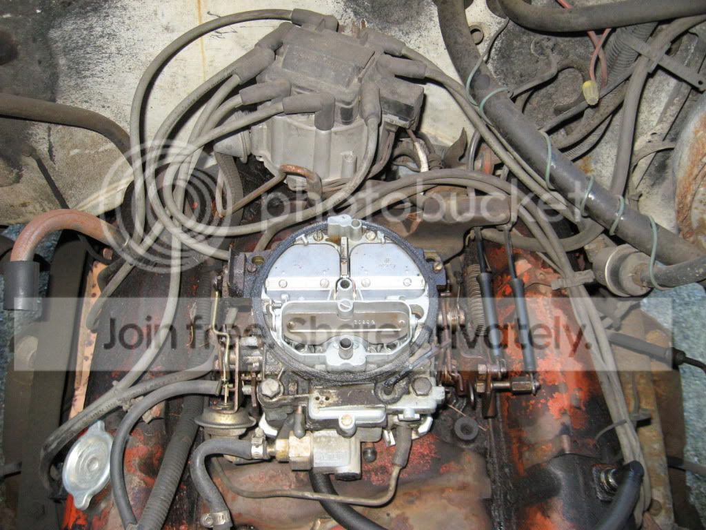

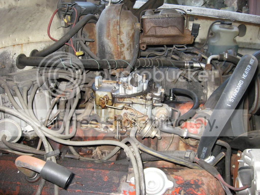

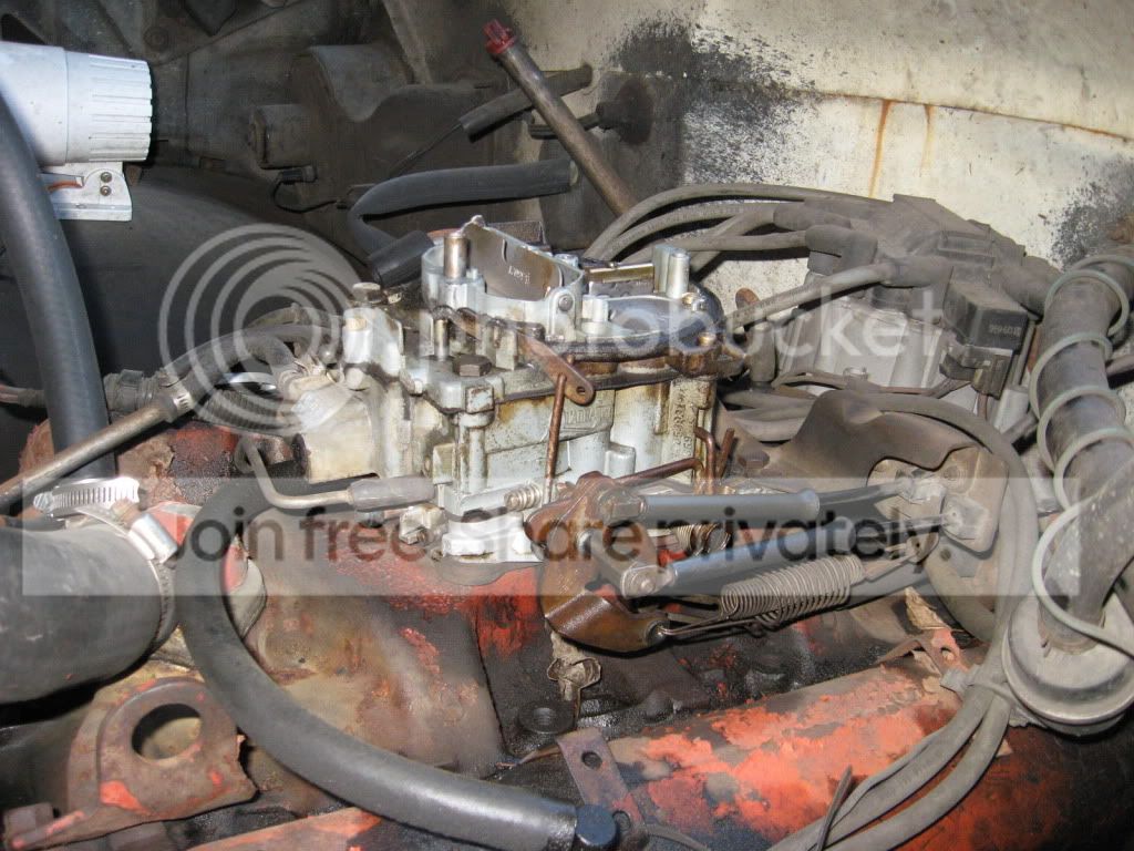

After much delay, I finally got a chance to take pics of the carb.
Thanks for the link to the carb decoding. The number stamped on mine is 17054931. About the only thing I can tell for sure is that it is a '76 or later Q Jet. The rest of the code doesn't make sense, at least according to the info on the webpage. I double and triple checked to be sure I had the correct number, so if anyone could shed some light on this, I would appreciate it.
Thanks.
It is definatly a Quadra -jet. It is the stock or close to stock carb for your truck.
In the third pic at the rear of the carb body there are a bunch of numbers stamped in the body. Hard to read from the pics but from what i can tell it is a 1976 -1979 year carb. Not sure tho the numbers are pretty blured.
Copy down the #s and post them up they can be seaily decoded.
The # should look something like this. 1705614xxx
Yep...I listed the carb numbers in my last post: 17054931. I will add that there is a four digit code next to it: 1659.
I've been checking the web for more decoding info and it's all somewhat confusing, since different sites have a different way of breaking things down for these carbs.
