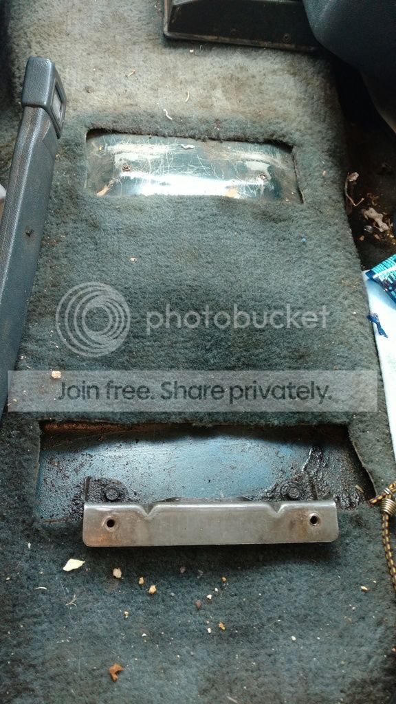

Hey guys, I have a 1987 k5 blazer custom deluxe that I am figuring has never had a center console since there aren't any holes in the floor or anything. There has always just been a big opening in between the seats and absolutely nowhere to set your drinks.....:doah:I have since ordered a new center console from LMC truck. The quality of it isn't really what I was hoping for, but its good enough for now. Anyways my question is how does this console mount to the floor? Is there some sort of bracket that holds it up off the floor or does it does it just bolt down? I cant find pictures anywhere, so pictures of how your console mounts would be greatly appreciated:bow:

Oddly enough I'm sitting in my Jimmy waiting to pick my daughter up with an unattached console
Here ya go
Rear mount height
You're a lifesaver man!:bow::thumb: Thank you! I have looked everywhere for pictures!
Lol you could not have posted at a more convenient time for me to take pics.
If you can't find that bracket I think I have one but it will be next weekend before I can get it
Haha alright! Well Im pretty handy with a welder so I think ill be able to copy off your picture and make a little stainless piece that will do the same thing.. I appreciate the offer though!
