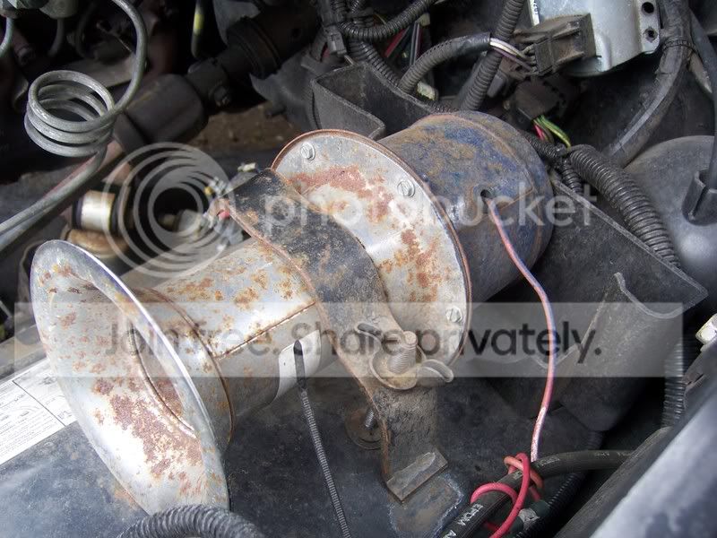

I need to get rid of this ghetto ass waaaaoooga horn on my Sub :crazy: The horn sits on the drivers side inner fender where the jack normally would go(and will go once I get this ghetto ass thing out of here).
Because pics are worth a thousand words:
Only one wire going into the horn

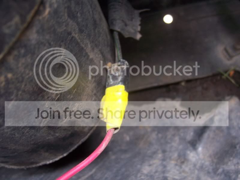

And that wire goes to this plug.. plug looks stock. I can't find any other wiring in there for it to plug into though
Your horns might still be where they belong, behind the grille.
I'd check that out, only one wire/connector to each, (there are two) looks like the right one in your picture.
According to the P/O all he did was unplug the stock one and plug this one in.. there are two wires into the plug.
What's the best/easiest way to get to the stock horn?
I keep blowing fuses with this POS :o
Take the grill out, should be one horn on each side of the grill. One of the wires going into that plug is the hot and that connector shoudl plug into the driver side horn, the other wire on that connector should be the loop to the horn onthe passenger side.

Got it hooked up! All was there.. he'd disconnected both horns and used the drivers side horn to power the contraption.. sounds like normal :wink1:
