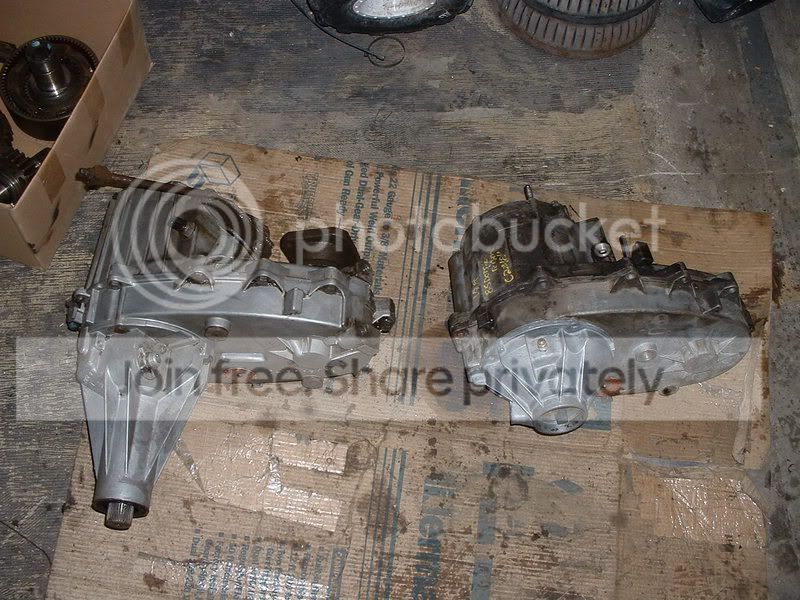

Here is a comparison of the Chevy and Dodge 208s:
Notice that the Dodge case has the fill plug in the center, while the Chevy has it near the top. You can also see the large threaded hole on the right side of the Chevy case that the Dodge doesn't have. This is for the bellhousing-tcase support rod, which Dodge didn't use. This might help you figure out which you have.
Now here is my converted 208 - the back half of the case is Dodge - modified with that threaded hole, the relocated fill plug (now I have 3 plugs) and a shift rail holder on the inside.

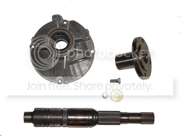

There are 2 other ways to make a fixed-yoke 208. Tom woods can machine your Chevy parts like this:
Or you can drill the end of the output shaft and bolt on a yoke (http://www.driveshaftsuperstore.com/drive_shaft_SYE.htm). This is just as long as the stock Chevy case.
