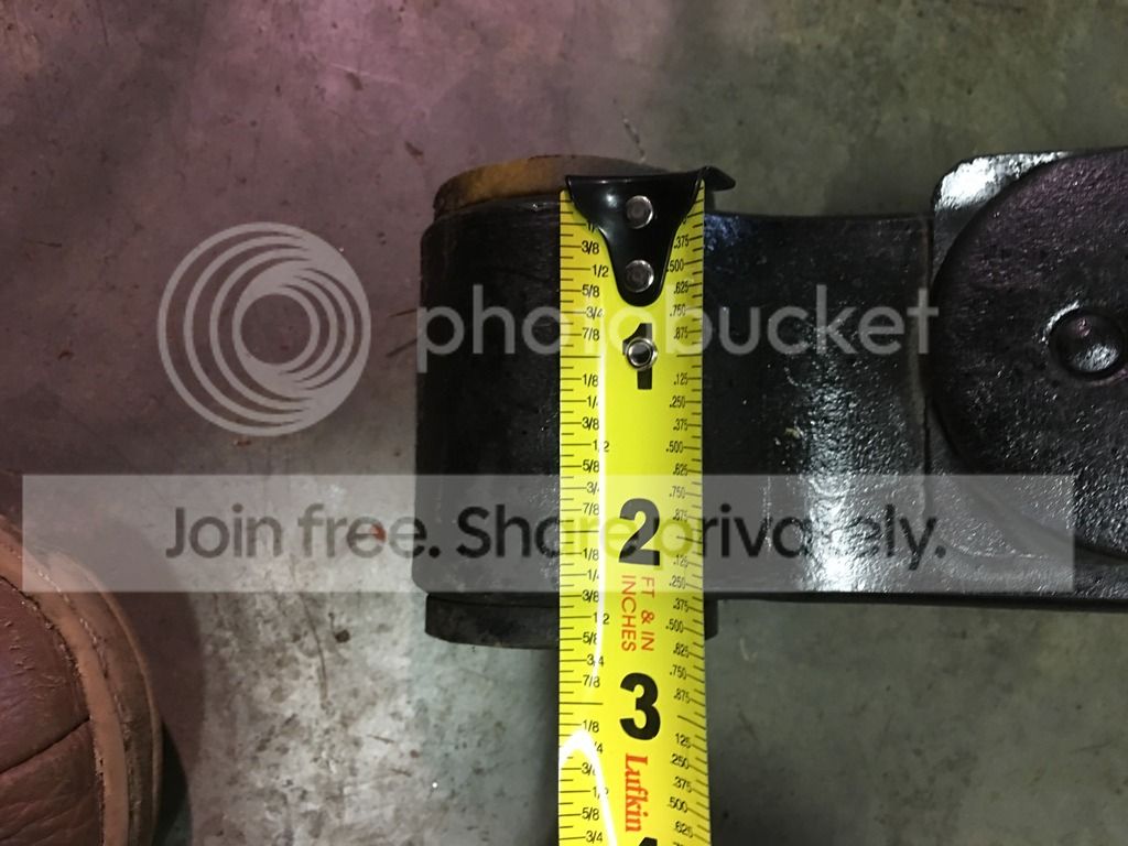

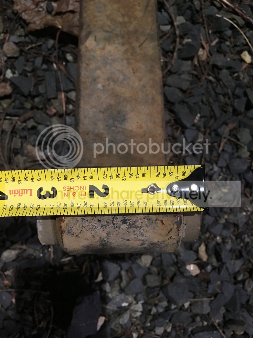

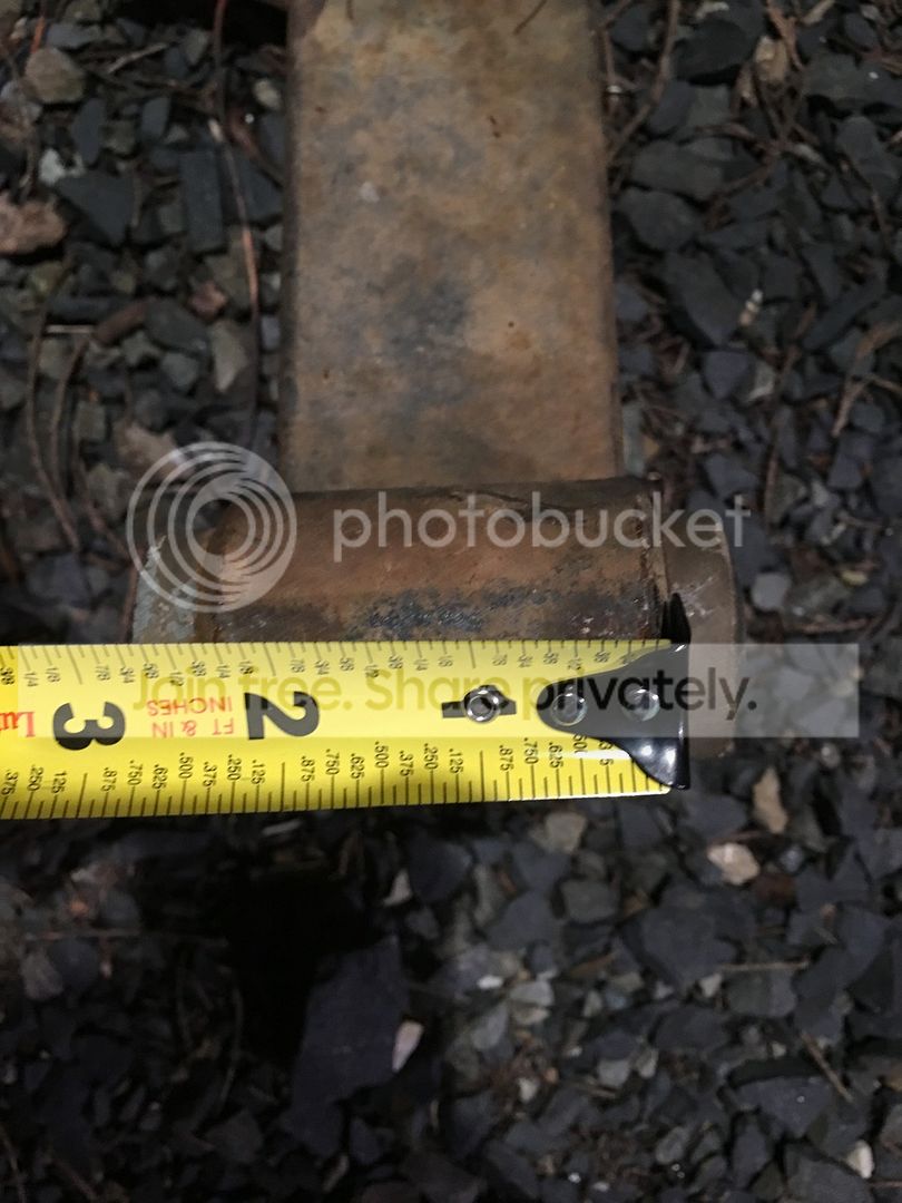

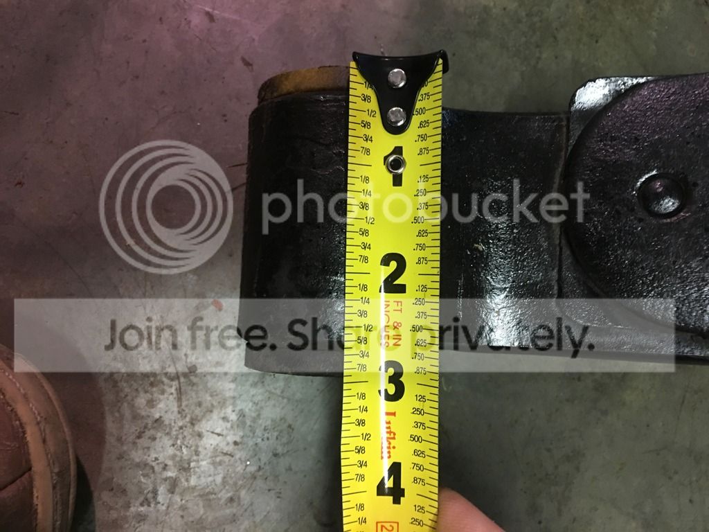

For those that might be looking up this info in the future. Looks like the actual spring on everything that I measured was 2.5" in width. The bushing is what made it wider between the widths. The width of the stock hanger is 3.5". The pictures are at a weird angle. The width of the smaller bushings is 3". All of my springs were aftermarket...
