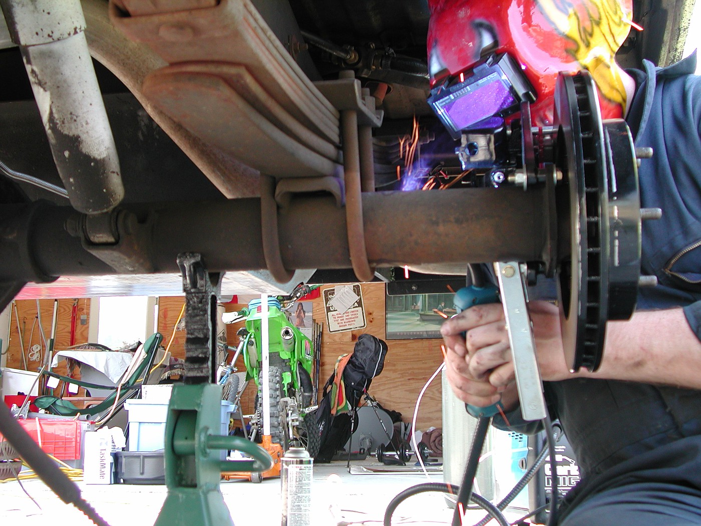

My stock suspended 71 has 4 leaves in the rear with 2 HD helper leaves.You can see them in the pic.
