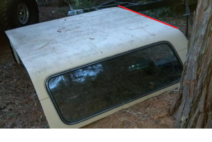

Along the red line is this the strongest point of the removable top? Would it be ok for long term storage to rest the top on edge of this red line and prop it up against a wall?
I have never heard of the tops bowing. I stored mine on some pallets outside for months and it bolted back on no problem. The fiberglass is quite rigid, but I don't think I would rest it on the back edge like that.
Why not rest it on the back edge?
I would worry about damaging the seal or having it compressed more than it would normally be on the truck. You could easily make a stand of some kind out of lumber that leaves the seal in the open.
Would it be ok to rest the top upright on the edge colored in yellow in this photo?
I think you're better off on the red line side. Preferably making a slanted platform so it's supported on the whole surface and upright.
The seal side is more vulnerable
For the record I had mine against a wall on the tips of the corners for years, and the only thing that happened was some minor damage to the paint and little rubbing of the fiberglass.
