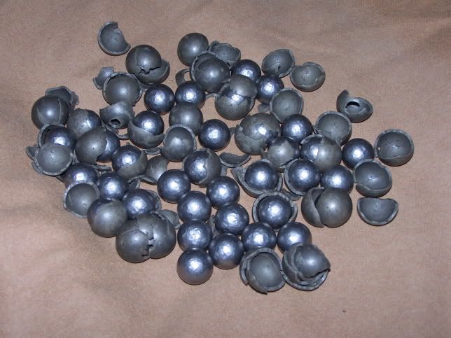

Ever wonder what would happen to a bunch of Mouseballs if you put them in your tires? They make 'em ride smooth, then turn into steel shot after about 200mi. and begin bead blasting the inside of your rims. I don't know what kind of mouseballs willyswanter uses, but I don't think these are made the same.
Cables Direct
I was going to do golf balls, but I was told that the outer cover on them wears off then the ball fall to pieces. Willys wanter uses mousemalls and says he likes them, but parently the noise doesn't bother him, or it's not as bad with the H1 beadlocks that he runs.
I will say this, that I can hardly notice a difference between running the balls vs. running nothing in the tires at all. These tires are not balanced at all and virtually no shimmy. They ride better than the 35" bfg Muds or the 38" SSR's that I had on my last truck and they were both road force balanced. I am impressed with the onroad performance of the Iroks. Now I need to see what kinda goo they sling. :rolleyes:

I think he figured out that it was the balls that he had put inside his tires to balance them.
