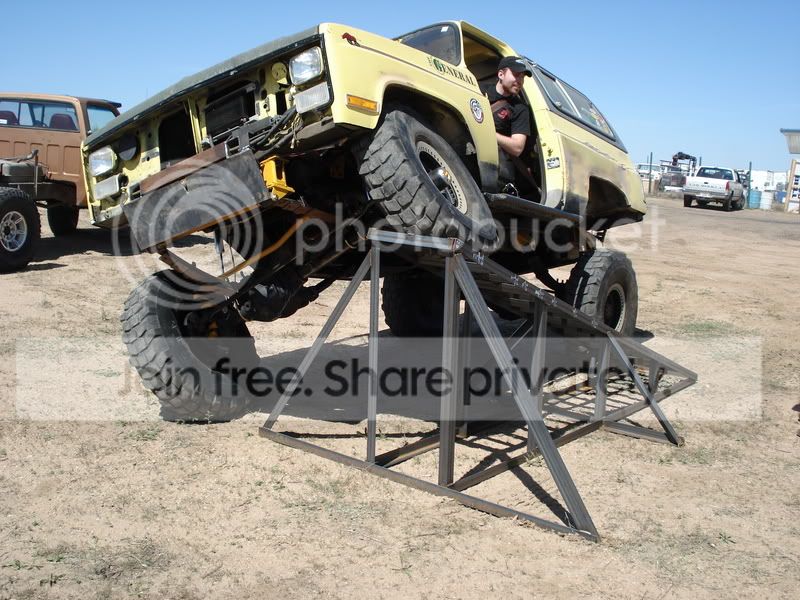

I did keep the 52" spring pack completely stock, same number of leaves, overload, etc. Suspension droop is great, but it can go too far. I'm very happy with how they work. I've seen too much droop and axle wrap create problems on other 52 setups. I still think mine flexes just fine. :dunno:
I have the bumpstops setup to contact just at the point the springs start to reverse arch. Before they would go quite far in the reverse direction. I RTI tested before and after the bumpstop install and the stops didn't hurt suspension travel.

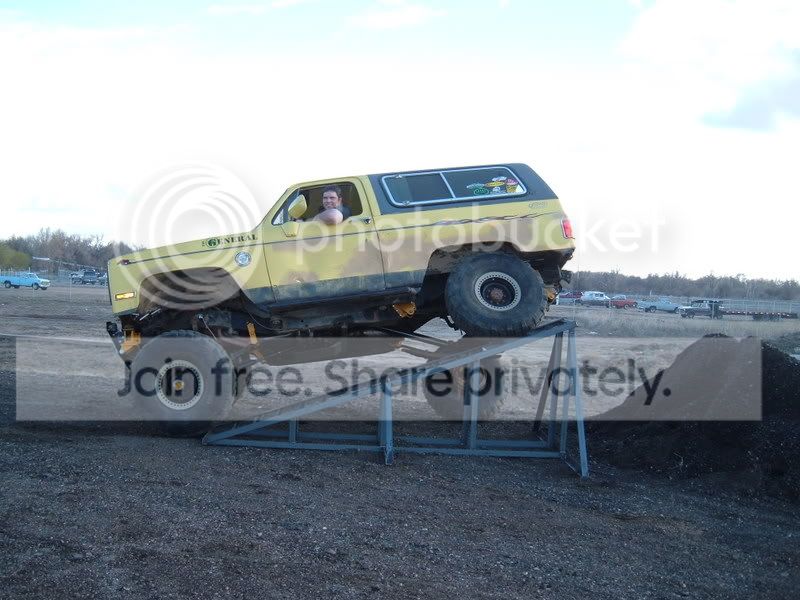

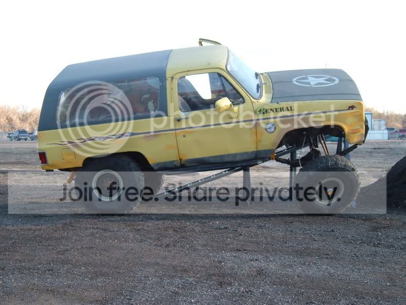

B_to_C said:
Wow mrk5, you sure gained a lot of weight between that first and second pic! :eek1:
:haha:
Yeah, in the second picture I actually have some biceps! :tongue1:
