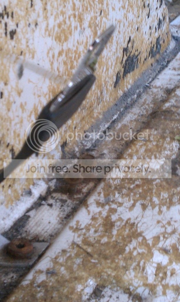

First things first, I got all of the carpet ripped out of the rear (since the PO did a horrible job piecing it together and to inspect for cancer) and I was wandering if somebody could tell me what some bolts are for? They are next to the right fender under the rear seat in the bed. Just behind the seat belt. I would include a picture, but I don't have enough posts yet. Once I get the bed all sanded down I will be doing a roll on bed liner. I just wanted to see if I was missing something, or if I can just take them out. Thanks for the help everybody!

Is that from alongside the rear wheel wells? Almost too close to tell. Is that brownish junk leftover glue and insulation from the carpets? What ever you do, make sure you clean up any rust before you put any type of bedliner on there.
Mine had a little (what appeared to be) hydraulic rod for the rear seat mounted somewhere like that. I removed it.
Good call, that is where the strut to hold the rear seat up when folded would mount.
Awesome, thanks for the help everybody. :waytogo: I guess I'll just get the bolts cleaned up and tightened them down like stated. And yes, that is all glue and leftover pieces of the carpet that you see. I have a couple wire wheels to get the area prepped for paint. I was planning on taking it all down to bare metal before rolling on the liner.
