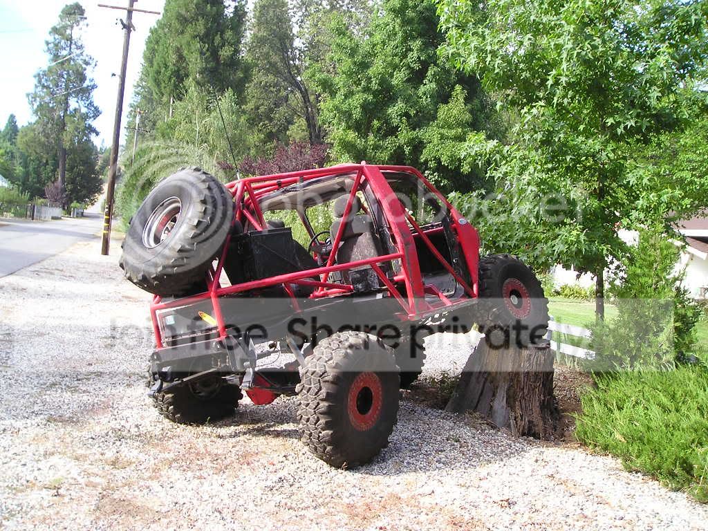

Had to replace a seriously bent TRE on my draglink, the stump looked like a good testing grounds. :D
How many times have you inverted your springs? I'm terrified that I'm going to break my 64s... everyone around here seems to want top dollar for them.
They get inverted everytime I go out. I bent them both right near the rear eye at Blazer Fest...I think just about any spring would have bent under the circumstances though. A 7 minute , balls to the wall, hammer down run through the tank trap broke both stock upper shackle bolts in the front, and bent both rear 64's a bit. The shackle bolts have since been replacced with larger 9/16" bolts. And I'm gonna head to the junkyard before next months 'Con run and find another set of 64's.
Ah, I set mine to run out of shackle before they invert. But, they still get pretty twisted in the front half.

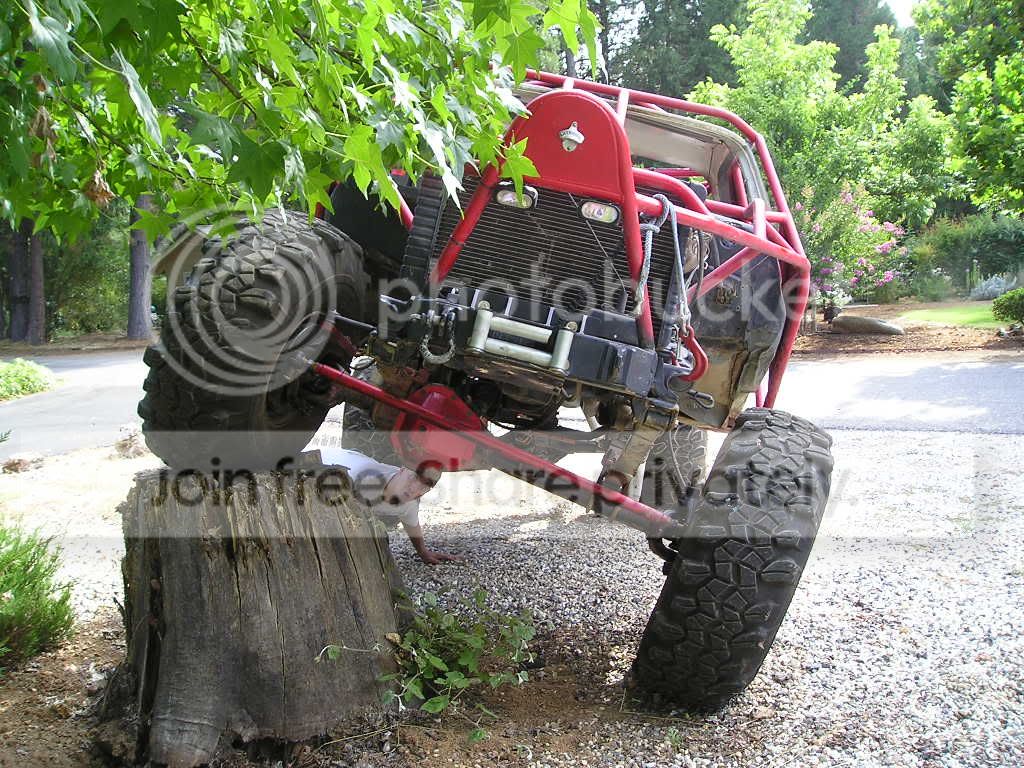

whos the funny lookin pet under there? ha ha just kiddin looks awesome i see you lost the windsheild and got some rock rash. totaly cool man
balzer
balzer
Ha! Thats my dumb ass buddy and co-pilot/winch bitch. Always gotta have his face in everything. :) :haha:

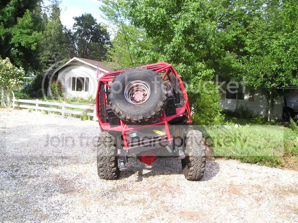

kidjethro i had a question where is ur gas tank?? im probably not looking hard enough but i cnat find it. is it a stock on? love the tube work. im kinda planning something similar when i start my project.
also im diggin the guiness bottle opener on the front and the plated pieces. what thickness did you use for those?? looks great
