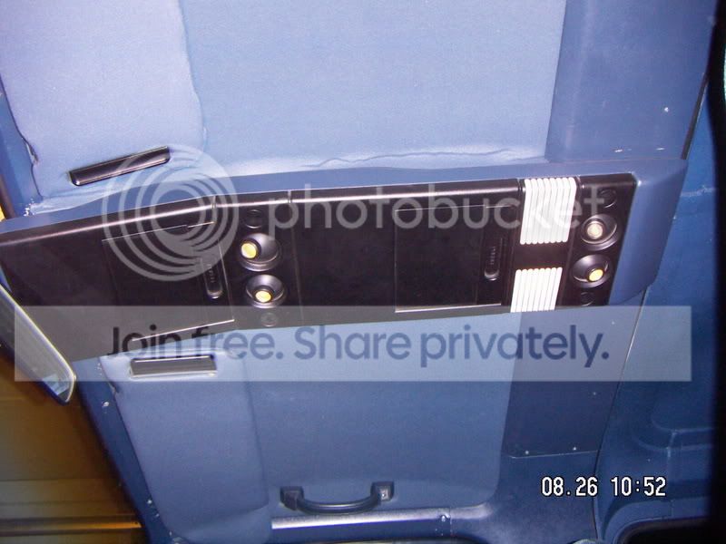

What all do I need to install a factory overhead console in my burb?i found a factory console but thats it.Do I need mounting brackets?Are the sunvisors and other interior panels the same?Thanks
I found this picture of one.My sunvisors are different and my interior panels dont have the part that goes all the way across the head liner like this.
IIrc, there's a mounting plate that attaches to the roof, then the outer console screws into that.
I have one out in my rig, I'll get some pics when I get the time...(lots of o.t.)
I mean, I have one I plan on installing in my rig....
The mounting bracket underneath the plastic console is riveted to some cross beams in the roof. Drill those out and the bracket comes out.
