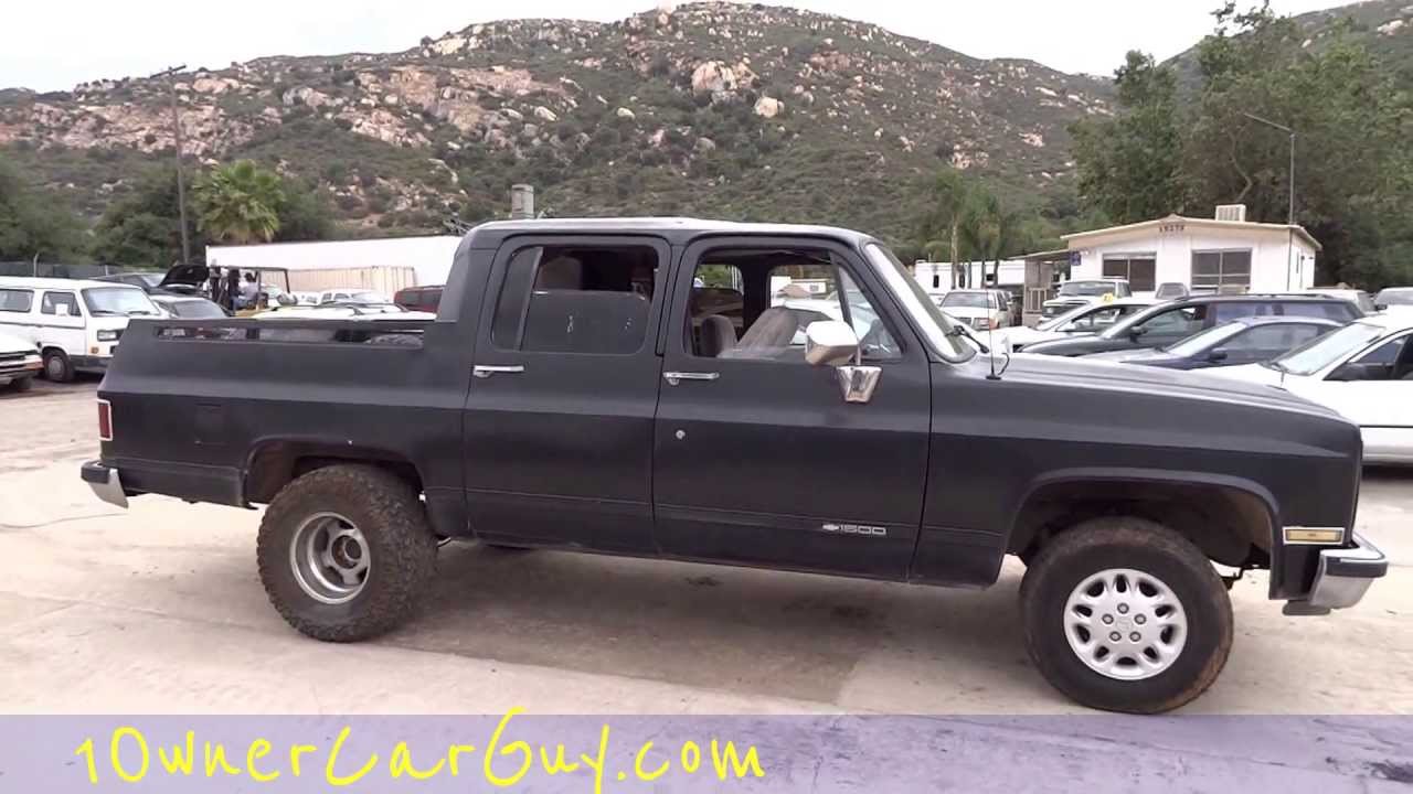

I installed a 4" Superlift on my 1991 V1500 last October and it has already sagged out in the back quite a bit. Has anyone solved this issue with load assist shocks or anything?
So I busted out the tape measure last night and checked the frame in front of the rear tires and behind the front tires and found that the heights are the same. I then measured the wheel wells (ground to top of wheel well opening) and noticed they are 4" different. I think the difference in opening heights is what is making me think the back is lower.
