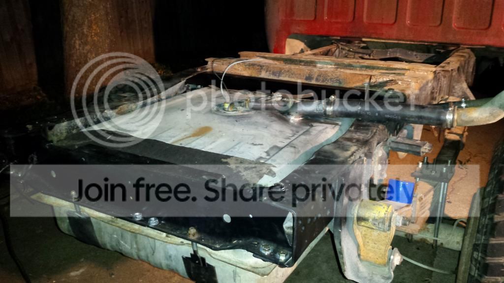

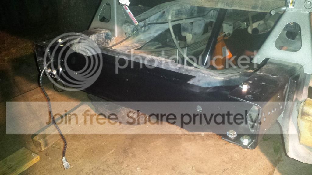

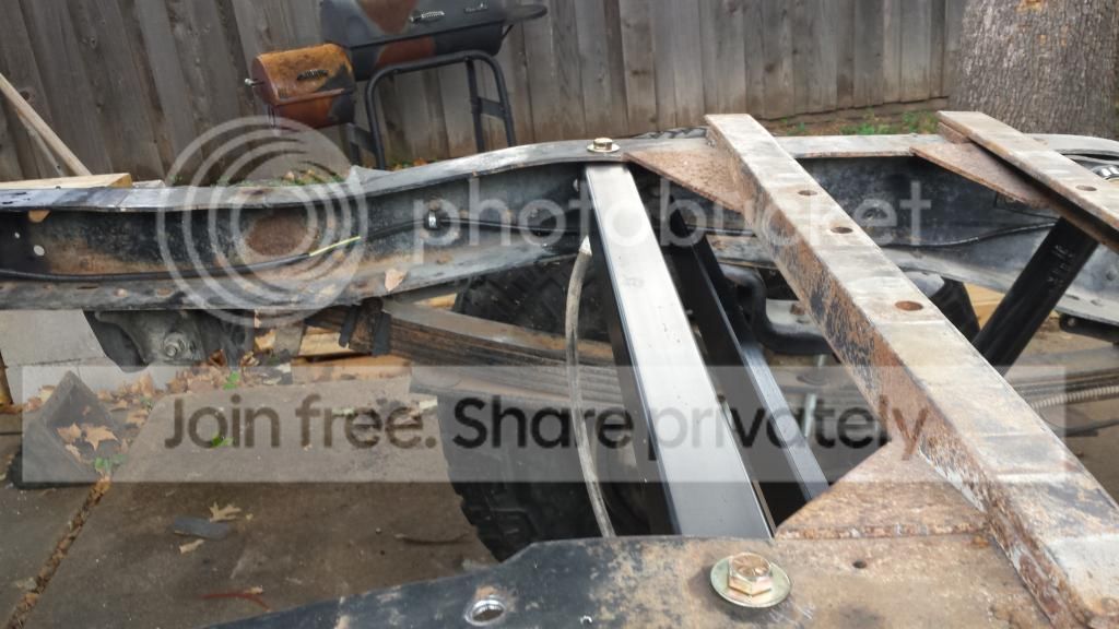

There's a 6¼" length difference in the 31-40 gal. Here how much frame I had left to work with.
More like 10", but yeah around there.
I think that rear cross member was 3" at the top. Not sure. Been a bit.
Here is some photos of when I did mine, I moved the rear crossmember back as far as I could. In the last photo you can see how much clearance I had with the 14bolt.
It’s doable but you have to push the tank all the way to the rear of the frame as shown above.
