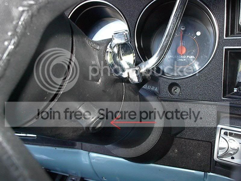

I was looking very carefully,on the steering column, on bouth sides, up'n down, and... surprize!!! I don't found nothing!!! NO hazard switch!!! Where can it be???dremu said:The hazard switch is on the right of the steering column, pull out to engage them, push in to disengage. (Or is it the other way around?)

Maybe not, if I change with the signal switch - the cruise control not work anymore, because the wires are cut. What do you think?dyeager535 said:The switch is part of the turn signal switch assembly, those four pieces (the outer collar, inner button, spring, and screw) are all held to the turn signal switch assembly by that single screw. You'll probably see where the screw threads in, unless it was broken off somehow. The threaded portion is inside the column, so pretty hard to do that.
