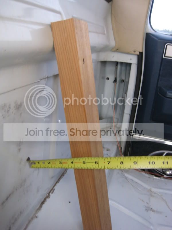

As anyone with a pickup truck knows, there isn't as much room behind the seat as in a blazer. With only a couple inches to play with, I was going to have to go with a shallow mount sub. I chose a Kicker 12" CVT shallow mount.

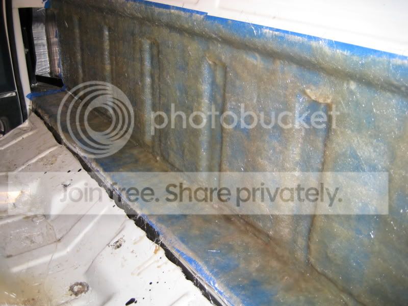

I ran painters tape all across the back wall and started laying fiberglass. This is messy as hell.

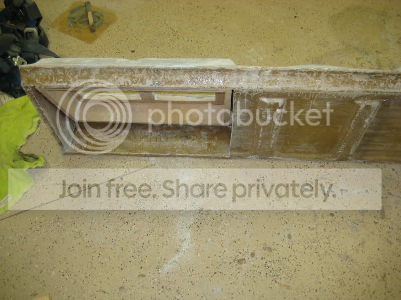

After getting a good few layers of a back and a floor of the speaker box, I cut out the internal walls of the speaker box and mounted the speaker ring. You can start to see how the speaker box will be split up. I'll have the subwoofer in the middle, the amps on one side and a small storage/glove box on the other to hold miscellaneous items such as jumper cables, tools, etc.

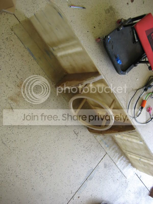

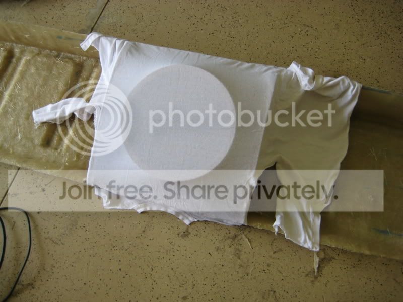

Stretching an old t-shirt over the sub ring for the first layer of resin. I did this for each of the three areas (sub, amp, and storage sides)

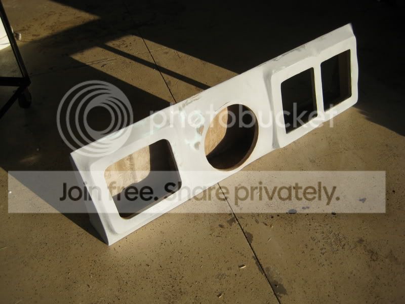

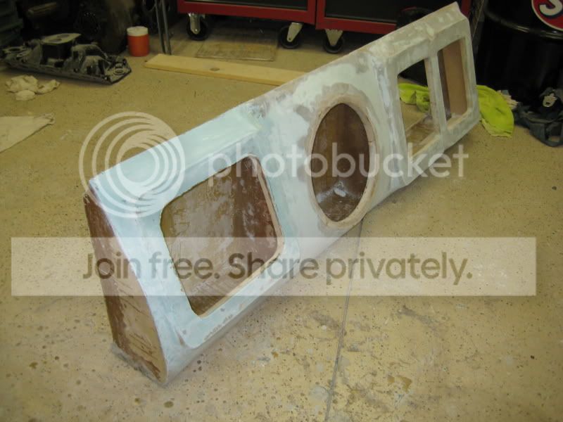

Here's the finished product after several layers of fiberglass and some bondo.
You can see how the amps will be mounted from behind in this picture.
After hours of sanding and more body filler and sanding and more body filler, and sanding some more, it was ready for paint.

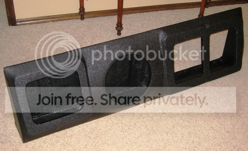

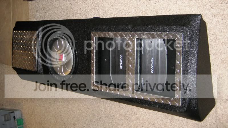

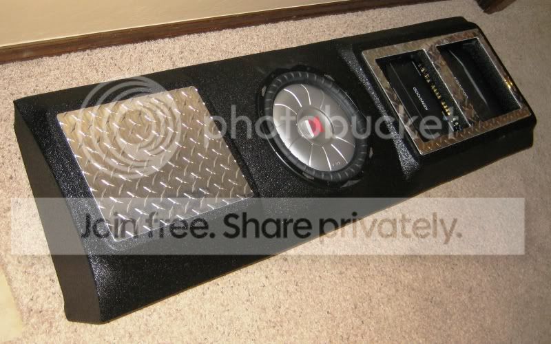

Well, I decided not to paint it and drop it off at the local LineX dealer. $60 to coat the whole thing and it will be much more durable than any paint I could use. Here's the end result.
Here's what it looks like with the sub, amps, and storage door on it. This is just the test fitting. Everything needs to be wired and I need to find some hinges and a lock for the storage compartment door.

that really turned out great. now you've got me thinking about ideas for the k5
cant wait to see it installed
