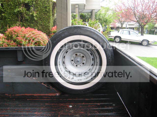

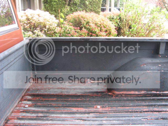

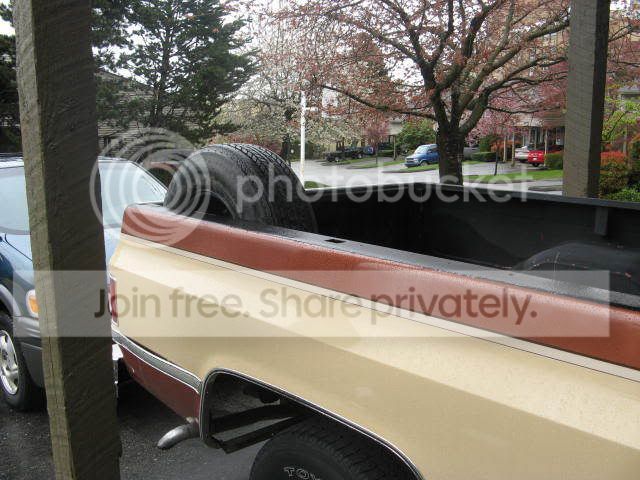

    I have a 235/75 tucked in there right now and there isn't much room between the tailgate and the wheelwell as it is.
    [​IMG]
    [​IMG]
    You can see you need a wrench to remove the spare. You could leave the all thread a bit longer, drill a hole and use a small padlock too.
    For a 35" tire I'd put the bracket at the front of the bed where there is more room for the tire.
