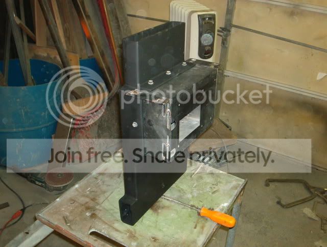

the core is about the same size as factory, and actually the fan blows better on high, than the factory one does... the only reason the factory setup performs a bit better is due to the proper ducting for defrost, etc.....
well, there are a couple issues with that... the summit unit has 2 round output's... you could run one as heat, than run one of the flexi round hoses over to the plastic defrost Y... round peg/square hole there tho.. you'd have to figure out a way to hook the round hose to the rectanglular opening... little custom adapter or something...
but more importantly, you have no option at that point to turn off the defrost, or floor heat.. it'll be blowing out both all the time...
even with my heavily modded fiberglass housing one in the K5, I'll eventually have to put in some sort of actuated diverter door in it to allow one or the other...
