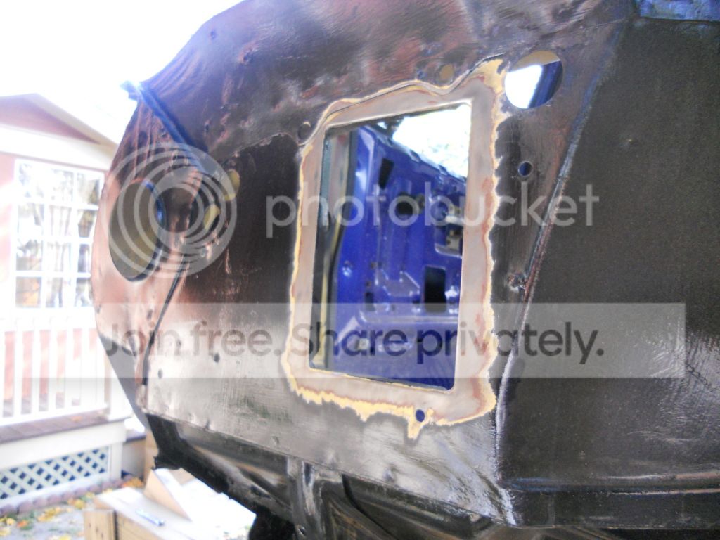

hey i'm interested ! talk to me about mounting... does it still seal up the factory AC / heating holes or what?
it does not. There is a rectangular hole, maybe 8"x6" and then like a 5" round hole, that i had plates welded over. There are also two holes where the heater hoses enter the cab, but where i placed the heater, i used them over.
As for mounting, it comes with a metal bracket on the top and bottom that are adjustable and they can attach to to the firewall by 4 screws, 5/16" i believe.
