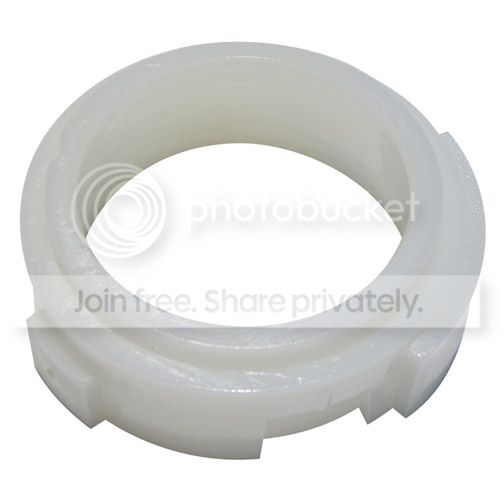

So I pull out my books and start digging. Then I find what I'm after.
Saginaw built GM columns but they also built Jeep columns.
Best part: Jeep uses same lower bearing and retainer and thanks to demand from the Jeep crowd, the retainer is available and only $2.99.
Be careful as some places want over $25 just for the retainer. Got mine here:
http://www.jeeptopdepot.com/productdetails.aspx?jeep-sid=453&plID=0&partID=6712

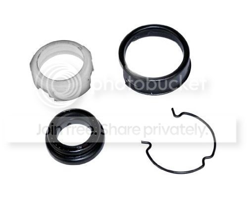

You can also buy the entire kit which includes the retainer, bearing, cup and the wire clip for about $25 if you shop around.
Listed as fitting CJ, YJ and full size Wagoneer.
Retainer part # OAI18019.02 or factory Jeep # J4487696
Full kit #OAI18019.03
Takes about 30 minutes to change out and if your doing the rag joint or XJ steering shaft, it would be a good time to do it.
These will fit 2WD or 4WD columns. In fact it'll fit any GM column as back as '69 and as new as '91 square body Blazer.
That's as far as I ever used them on. Anything beyond those years is up to you to figure out.
