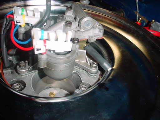

you sure there is no vacuum source in a chev reg system?
is that a chev?
with reg mounted interal with TBI unit it appear to have a passage to the spring side of the reg which would be the reference line
Here is a link to an install of a vaccum fuel pressure regulator and some pictures of the units. That throttle body you showed doesn't appear to be factory to me, I could be wrong, and I don't really see the vaccum line, there is a mess of them. It very well may have a unit. I always wanted to install one of these on my 95 TBI pickup, if I were keeping my 89 burb I may well have done it on that.
http://z28boy.cz28.com/tech-vafpr.htm
Sled dog is right Chevy does not use a vacume controled FP reg in tbi cars or Trucks. They did use it in marine applications on BBC to get better fuel economy.
