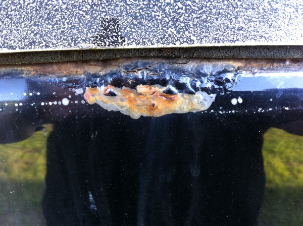

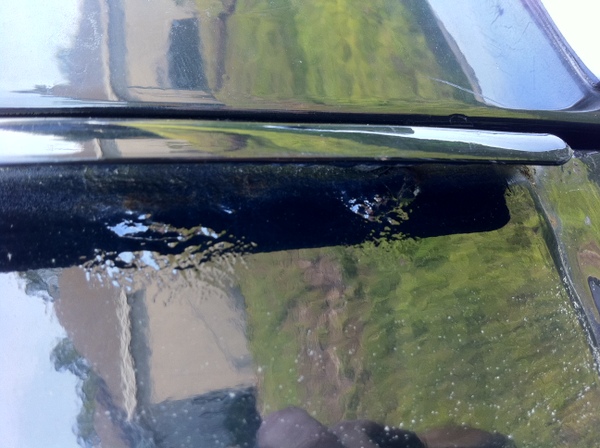

Okay, here are the two images of rust on the truck.
What would the best way to eliminate it, patch it now and have it still look decent and last until next year when the truck gets full paint restoration?
That upper bedside rust is not sexy at all, in fact you can see the scaling is compressing the topper seal in that area which gives you a good idea how bad the scaling is there. That one is a cut and replace fix for sure.
The second pic, I cannot figure out what part of the truck I'm looking at. Also hard to tell what is reflection and what isn't etc etc.
Rene
The second pic looks like the rust was painted over, which may mean it's been rusting even more underneath the paint, but it doesn't look like normal rust under paint since it hasn't broken through the paint. Maybe it was just bad body work?
My not-so-expert opinion is to just leave it alone if you are only going to wait a year. The metal underneath is already destroyed so sanding away only part of it now wont do much to stop further damage. You need to remove all of the rust to stop it and after removing all the rust, if you don't protect all of the newly exposed metal underneath, it'll rust again and cause even more damage.
