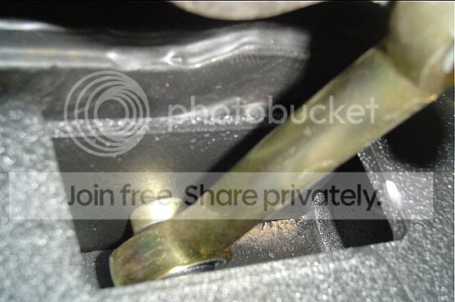

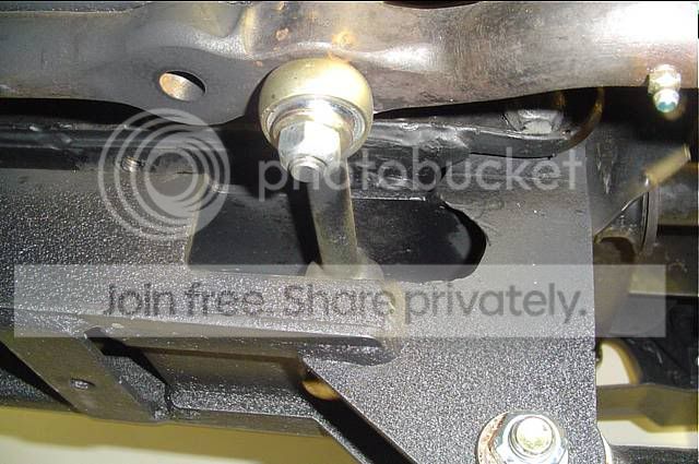

I have put 400 miles on the kit so far and was crawling around under my Avalanche truck checking things out when found a problem. There are 2 heim jointed links that run thru windows in the front drop crossmember. They connect from the crossmember to the centerlink. Both of these links have been hitting on the outside of the windows in the crossmember. One of the links (passenger side) is actually bent a little from this contact. Photo is of the passenger side link, you can see the little notch in the crossmember on the right side created by this contact.
To date I have checked out three HD trucks with ProComp kits, they all have contact here and bent arms on the passenger side...just like mine.

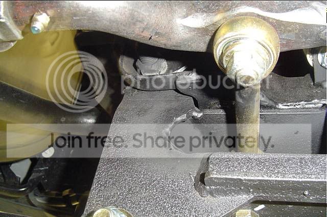

4WP ordered the link last week and it seemed like they wanted to keep the matter quiet. They stated that they would be replacing the bent link and grinding a little clearance.

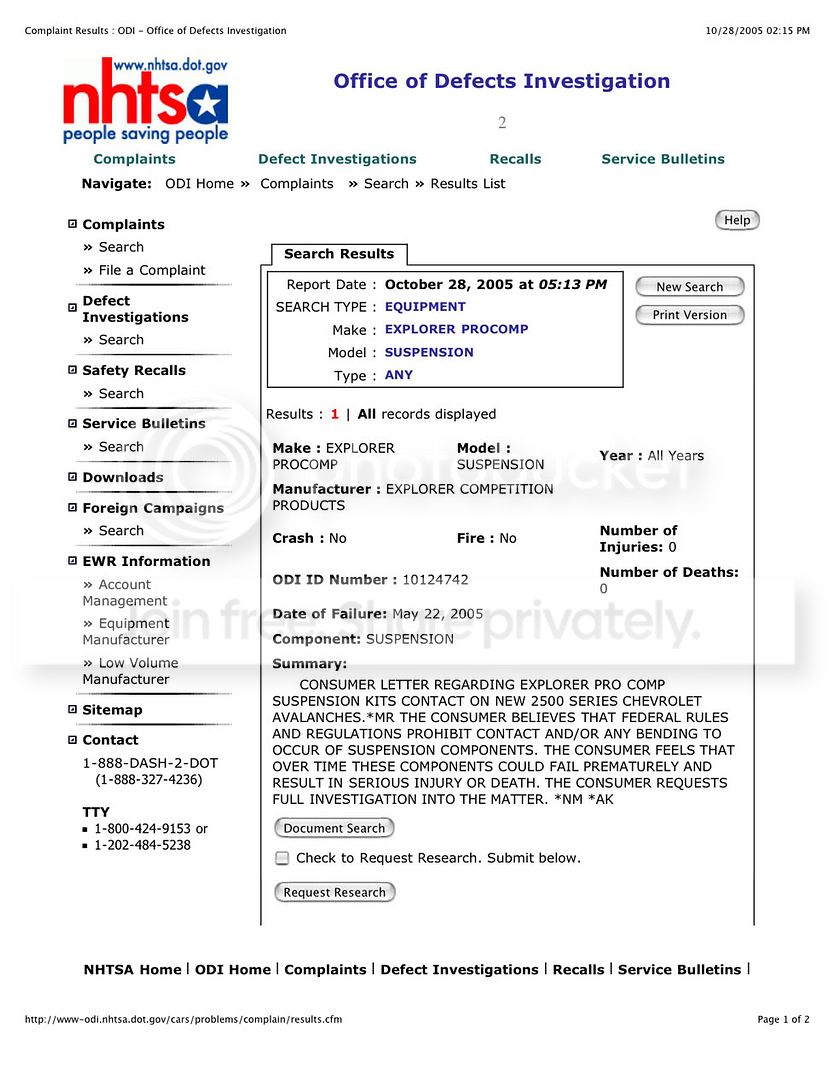

4WP did a really crappy job grinding and spray painting......thier so-called fix to the solution for thier PRO CRAP Suspension Kit. It pissed me off so much, that 4WP owner of Explorer Pro Comp, hasn't even sent out a letter to thier customers to fix this problem, so I filed a compalint with the NHTSA to make PRO COMP replace these parts instead of grinding them down.
(National Highway Traffic Safety Administration)
Office of Defects Investigation
http://www-odi.nhtsa.dot.gov/ivoq/
U.S. Department of Transportation NHTSA
C/o Office of Defects Investigations
NSA-10.01, 400 7th Street, SW
Washington, DC 2059

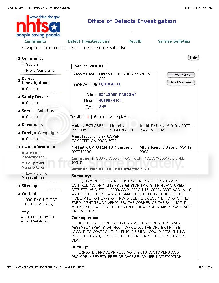

So then I began running more searches on this company and its Pro Crap Suspension and found out that they are they only company to have a RECALL on thier suspension systems.
From the trend of problems, it looks like this comapany was not spending enough money on Research & Developement.

GM just announced a huge brake RECALL on 804,000 trucks....i think i might start a new thread on it.
DETROIT (Reuters) - General Motors Corp. is recalling 804,000 full-size pickup trucks and sport utility vehicles because of potential brake problems, federal safety regulators said Tuesday.
The National Highway Traffic Safety Administration said unwanted application of the antilock brake system in some vehicles can cause increased stopping distances during low-speed braking and may result in a crash.
Vehicles affected by the recall include the Chevrolet Avalanche and Silverado pickups and the Chevrolet Suburban and Tahoe SUVs. The GMC Sierra pickup and Yukon and Yukon XL SUVs are also affected. All 804,000 vehicles trucks are from the 1999-2002 model years, NHTSA said.
http://www.detnews.com/2005/autosinsider/0509/01/E01-298706.htm
