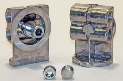

Your going to need the fuel filter that goes on the firewall.
you can use these...get rid of the old troublesome stock unit. I'm gonna swap at the next filter change...:waytogo:
filter
filter base
My '85 Burb has a Racor filter someone put on it--I'd rather have the stock GM one like my '82 k2500 has with the Wix 33123 filter--the Raycor filters aren't readily available at stores and are expensive,and the unit is made of plastic,looks like it would break very easily...doesn't hold much fuel compared to the Wix one either...I'm not that impressed with Raycor filters,if the truck didn't have a spare cartridge that fits it come with it,I'd have already ditched it probably...

:popcorn: Hadn't thought about the filter. Is that the NAPA filter base? i got one and used it for a coolant filter from flrrtfilter.com, way cheaper than the local NAPA.
The fuel filter & base can be had from several sources,Wix sells them,NAPA sells them under their own brand name too,and I have seen "Perma-Cool" brand ones in Jegs and Summit catalogs for about 35 bucks with a water separator filter....they look almost identical to the stock 1982 filter and base on my truck that takes the 33123 Wix filter..
