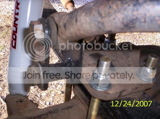

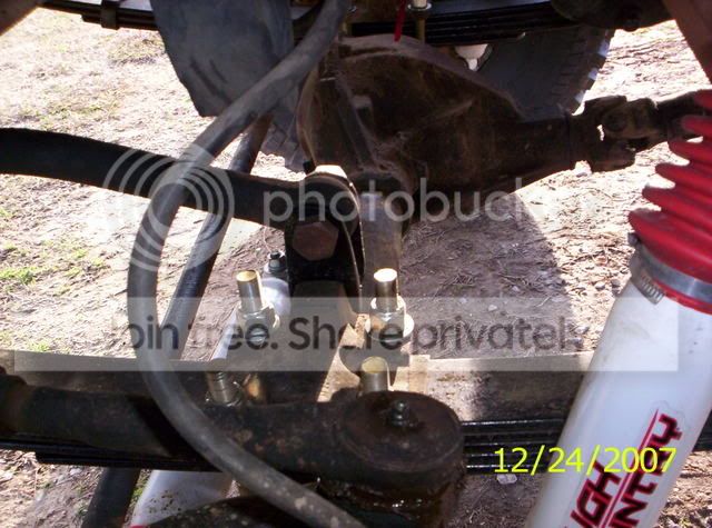

here is some drop brackets i made. all they need is a right sized tractor pin and they could be disconects too... i just never disconect it.
Something like that, but with longer links to the spring plates may work to clear the drag link in a x-over setup, but the driver's side link would need to be moved outboard of the spring pack to clear the frame which would require lengthening the sway bar.
