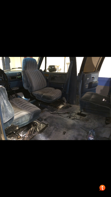

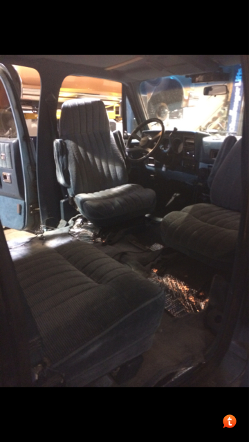

Here's a couple shots with them swiveled. Note that I have the larger (driver side) rear bench removed in this picture. Also, the shiny stuff is my heat shielding under the carpet.
Note no center console. Also note that because of the steering wheel, the drivers seat doesn't go 180. But the mechanism does. I might do a removable wheel?
