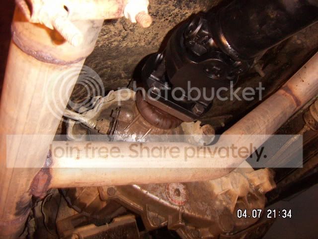

I used the stock front output flange and had a C/V driveshaft built to match. Shaft didn't cost any more and the flange was free. This is the flange for the 3R (saginaw-style) joint. 3.125" pilot and 4.25" bolt circle
You can machine the stock flange flat and drill out the threads and bolt up a 1350 superduty shaft.
